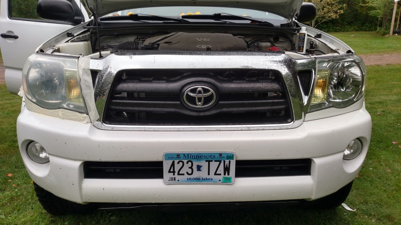

    IMG_20190907_105944589_HDR.jpg Just restored my headlights, turned out great. Took a little elbow grease but the Meguiars kit worked awesome. Pic of 1 finished.

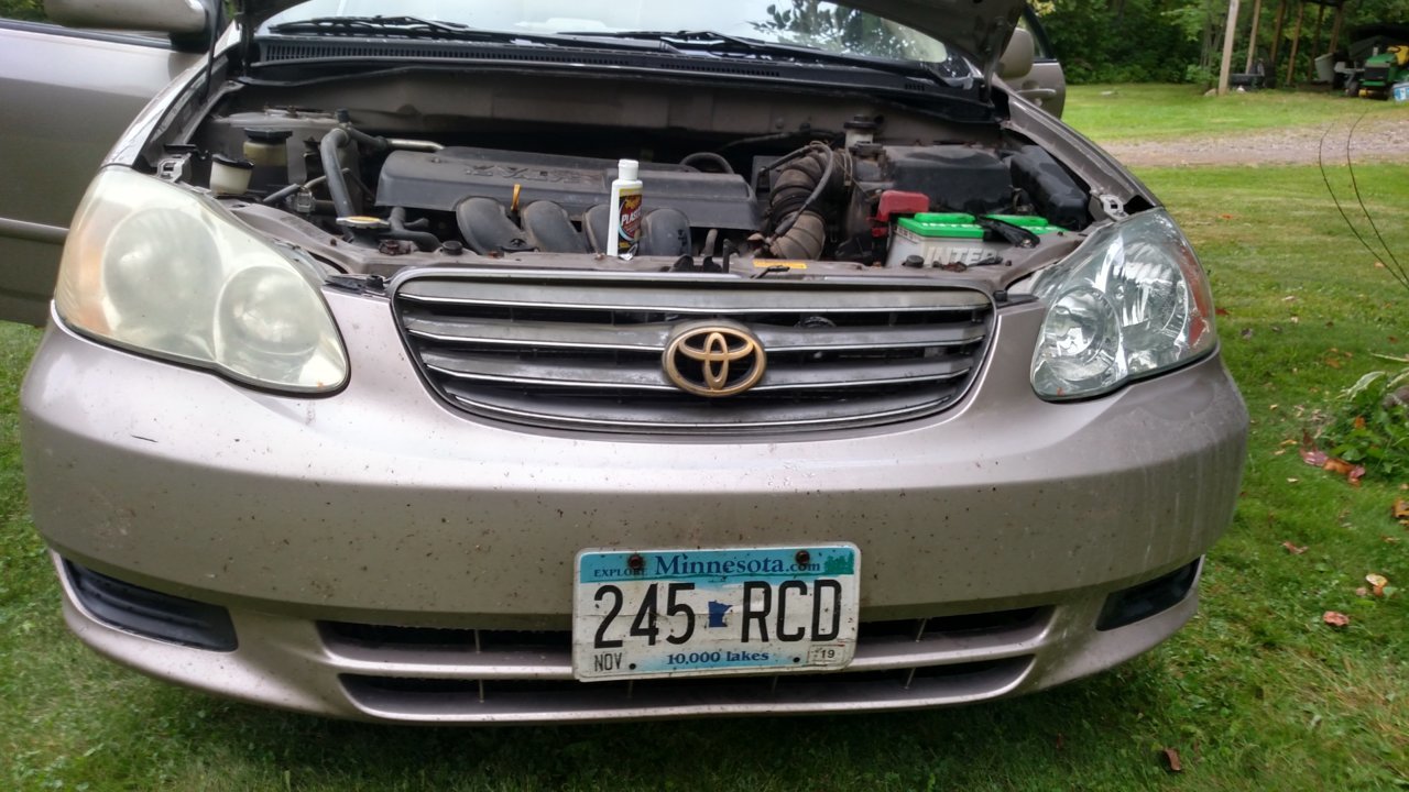

    I purchased the Meguiars heavy duty kit at Walmart for around $25. The kit came with a hand sander with 2 wet sanding discs, 1000 grit and 3000. Also came with a buffer for a drill, and polishing compound. The last thing is the sealer you apply with a provided small sponge. I was impressed with the result. Did my 03 Corolla and my son's 2000 Camry and they both turned out great.
