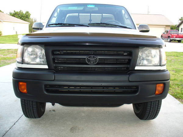

    Or you could buy this ^^^^ and never have to redo the headlights again like I had to with every other brand of "headlight restorer". This stuff is the only thing I will ever use again. yeah $20, but worth every cent. My headlights were foggy as hell, look at my pics and see them now. It has a eurathane sealer in it so they will NEVER yellow or fog again. And a lifetime warranty. If they ever fog or yellow, they will buy you new headlights. I did my step dads Sebring with this stuff, 2 years ago, and they are still perfectly clear...

    Some type of paint sealer, clear coat of some kind, 10 coats of wax...? That Crystal view stuff I put in my post has an acrylic sealer. I used that Quixx stuff, my lights fogged after a month, McGuires after 2 months, I used the 3M stuff and it lasted the longest at 4 months on a Sunfire I had. If you use that other stuff all it is is a rubbing compound, and the finish that is already damaged is removed, the plastic is unprotected, and it oxidizes again because it has nothing coating it to protect it. That Crystal View is permanent, and warranted for life. I have used it for a couple years now on a couple of my cars and family's cars. My step dads Sebring had really yellow headlights, I used it over 2 years ago, they are still perfectly clear. I did my tacoma in march, here in Florida where the sun ruins everything they are still like new.
    Just a heads up. Napa must sell a sealer for the headlights. If it starts fogging, try the stuff I am talking about, believe me, it's awesome stuff.
