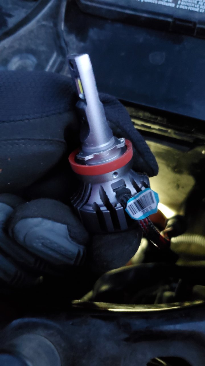

    Installation:
    These were relatively easy to install since they are plug and play. There is a collar on them which is adjustable by an allen wrench that comes with the lights. 3 of the 4 lights were perfectly adjusted while the 4th required a little adjusting of the collar. Like any LEDs, these work best in the vertical position, otherwise you'll definitely produce excess glare, not get the proper hotspots, and possibly have a terrible output to begin eith. With the high beams, I lined them up with the ridges in the reflector. The low beams I just positioned up and down. You can tell this by locating the position of the cord coming off the lights, which is always located at the bottom when vertically aligned.
    The drivers easily tucked away and weren't an issue. Initially I had one fall down below the washer fluid reservoir and was banging on the front bumper. I tucked it in a bit better and it was never an issue after that.

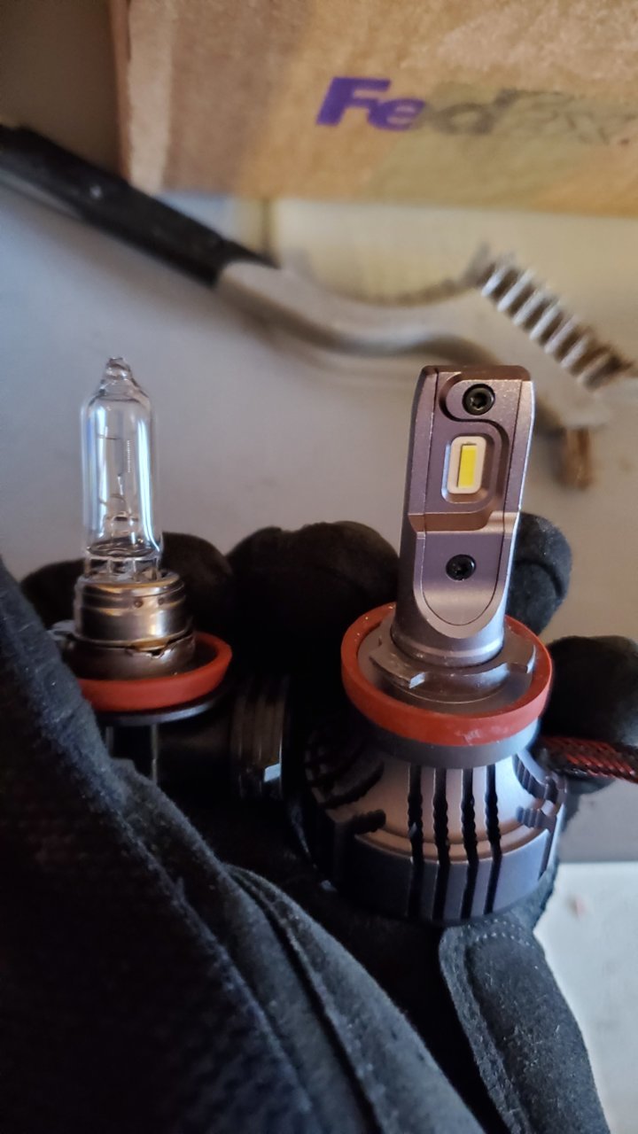

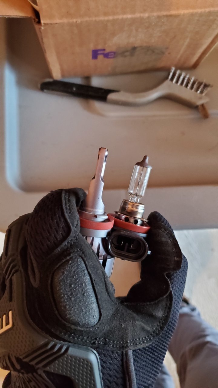

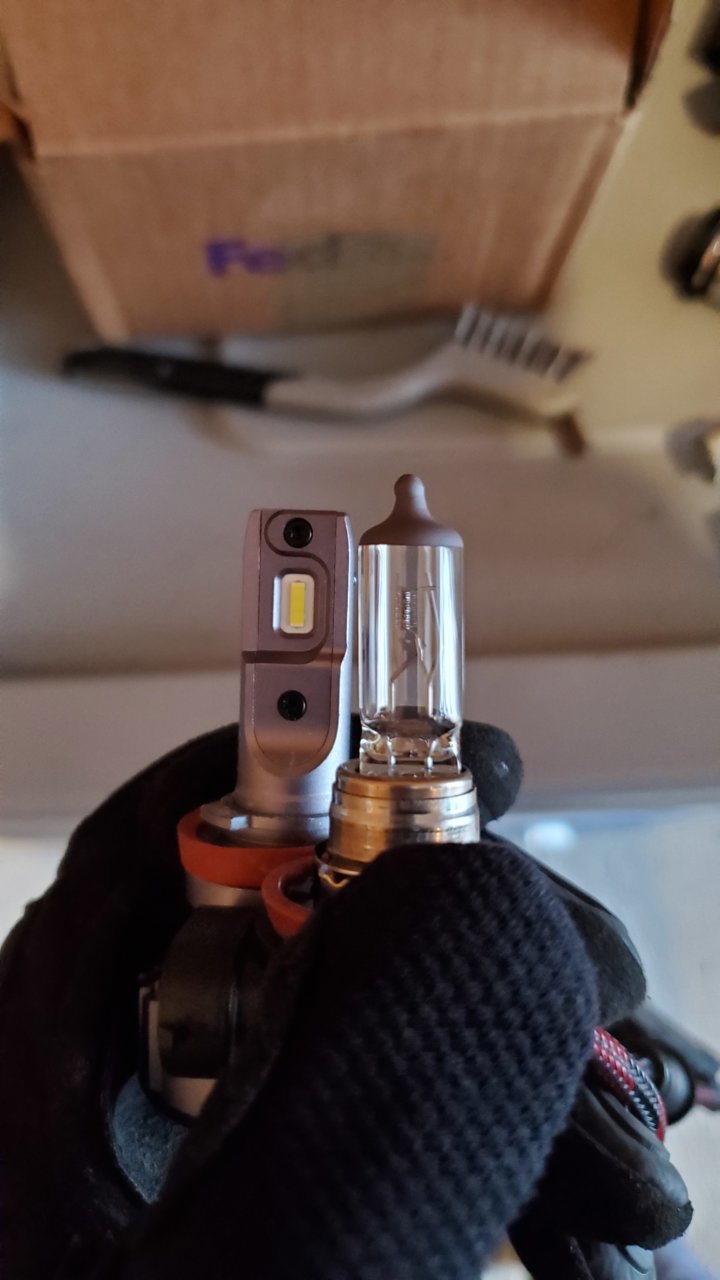

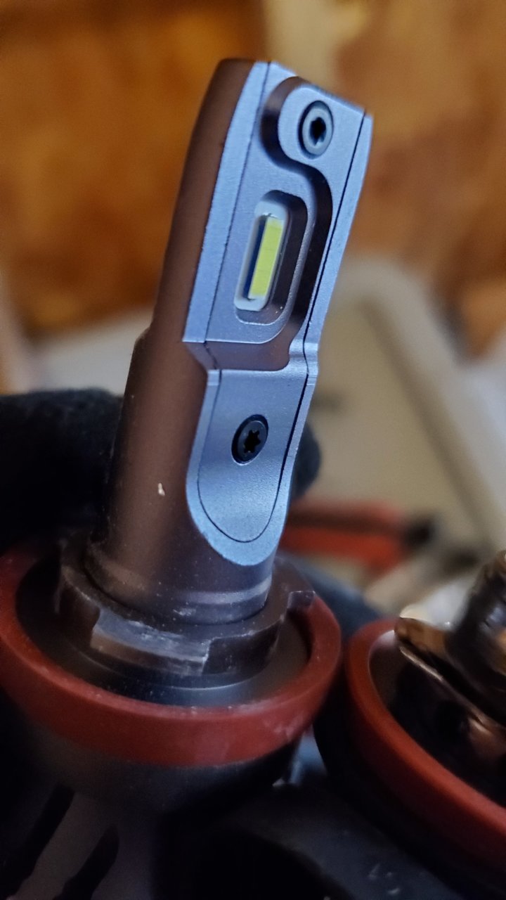

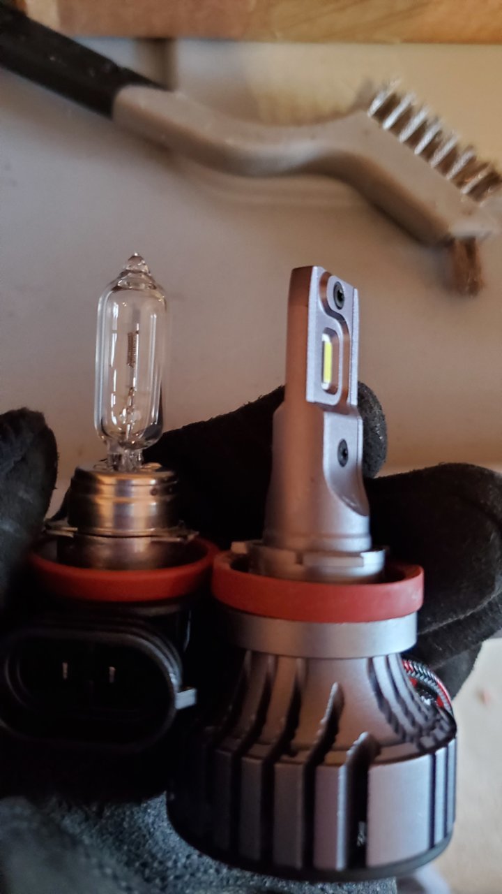

    These are pretty much your standard LED build featuring a fan on the heat sync. I believe these lights are designed to run at a lower power if they get too hot, but I've never run into that even at 90°F+ outside.
    I attempted to measure the width of the LED chips since that is the place LEDs are handicapped the most. However, this proved difficult because the LEDs are recessed in the frame so far and I did not have the tool to take apart the frame to measure it without the frame. So, therefore, I had to improvise. The reading I got was approximately 2.54 mm. That's slightly narrower than the 2.6 mm in the Hikaris from the megathread, which were the only aftermarket LEDs recommended in there that weren't dedicated LED housings. However, I do not have the same calipers used in the megathread that allow for measurements in recessed areas so my measurement needs to be taken with a grain of salt.
    In theory, the place that you'd likely notice the difference in width of the LED vs Halogen will be the width of the beam pattern (assuming proper alignment). However, I could not visually see any difference.

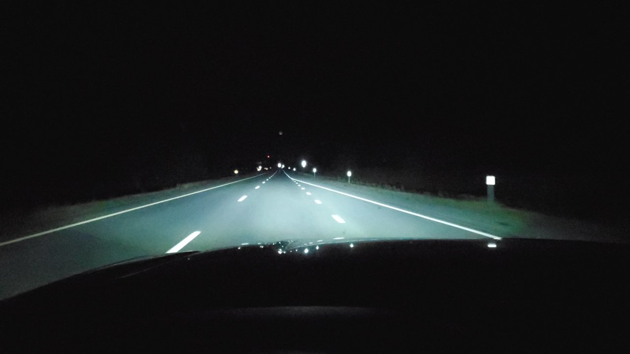

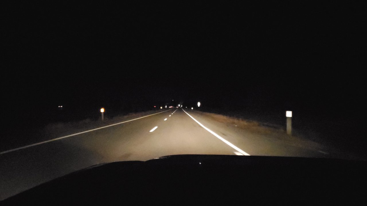

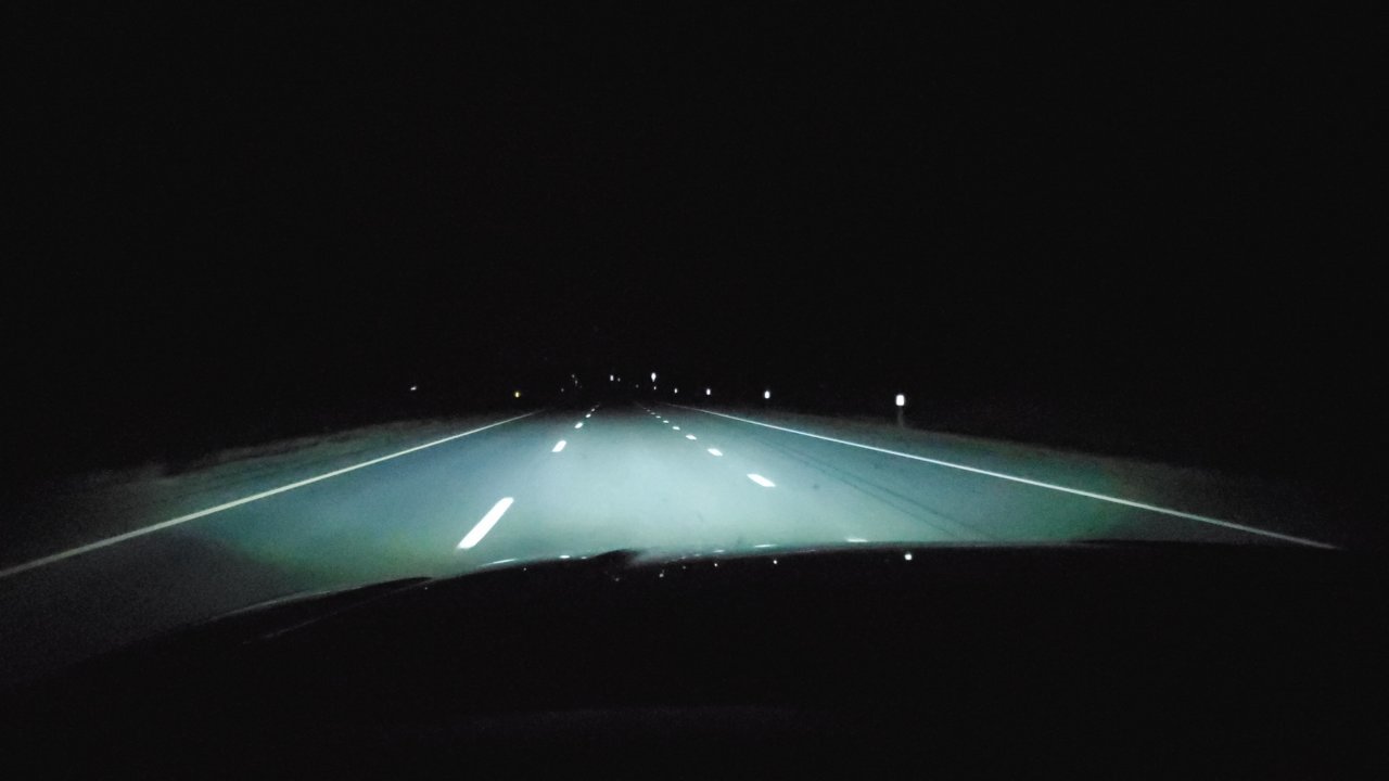

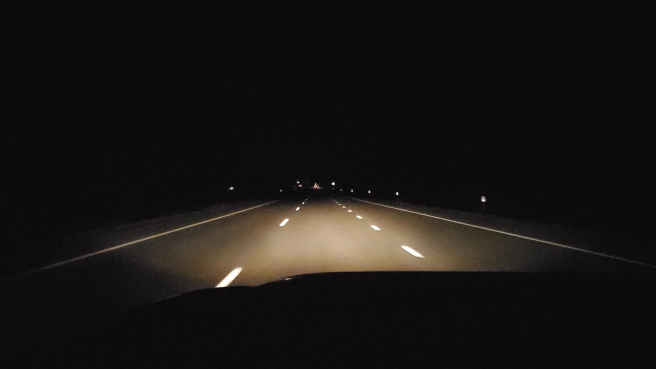

    Photos:
    These photos were taken on the same stretch of road at the same time of day. The pavement was dry and there was no moon, nor other traffic to assist with lighting. These photos were taken using the Samsung Galaxy S10+ in pro mode with as close to the same settings as possible. It was approximately 54°F out for the LED photo and 35°F for the halogen photo. Both were taken about 35 minutes into my commute.
    White Balance: 4700K
    Iso: 3200
    Aperture: F1.5 1/50 speed
    For whatever reason I was not able to adjust the contrast manually. The LED photo was taken with -1.3 while the halogen was taken at -1.7 despite my best effort to make them match.
    Low beams:
    High beams:
    Comparison:
    I was working with what I had at the time, so these aren't the best visual references and I apologize.
    Compared to H11:
    Compared to H9:
    Close up of the LED chip:
