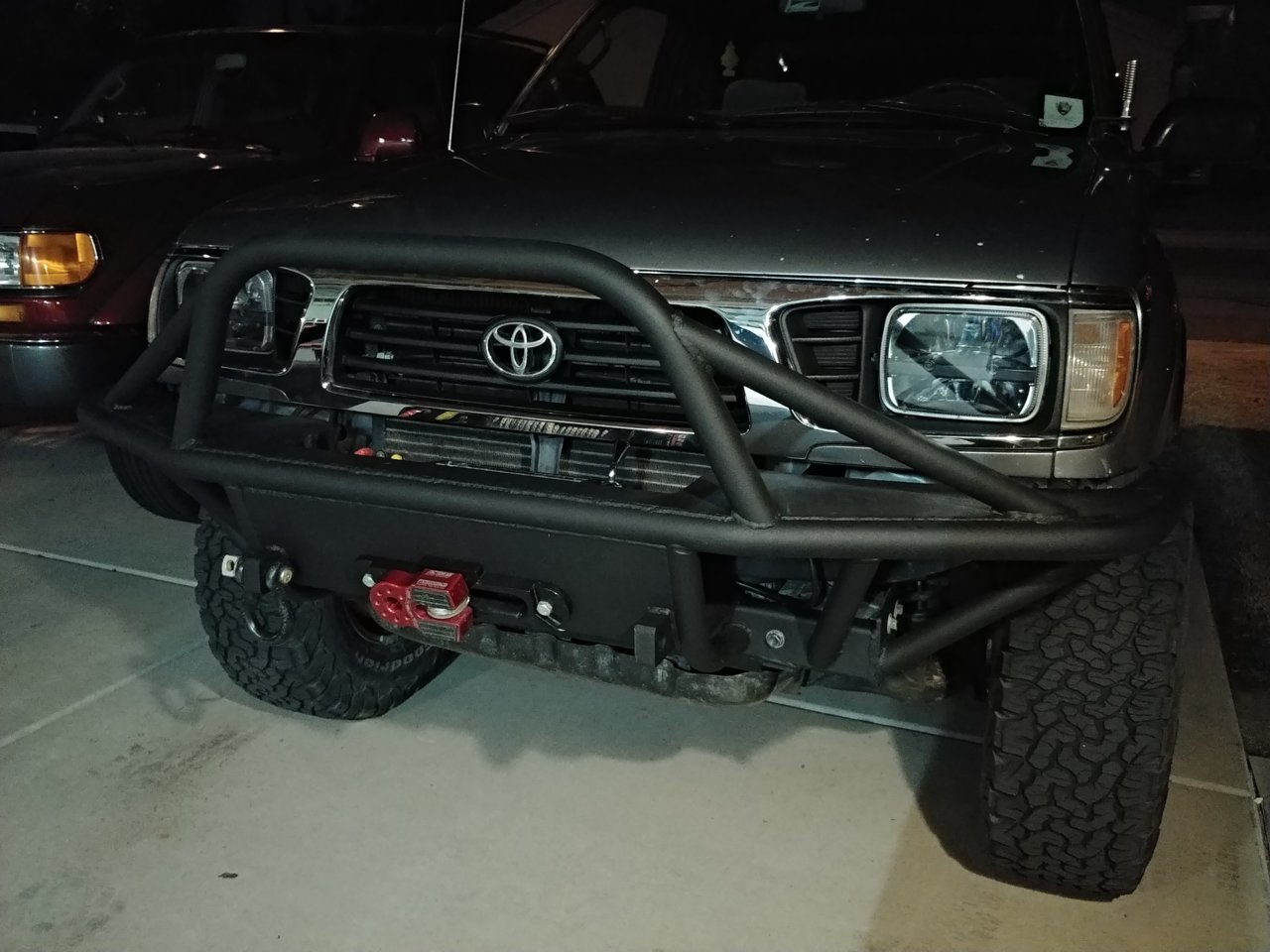

    Anyone know of some good headlight options that use the stock harnesses or an easy install upgrade?

    For early second gens you need to get the H4 conversion from sealed beam. This switches your headlights to a fixed lens where you can then change out the bulb, which is far higher performing. While more expensive, I highly recommend Hella E-code 200mm lenses. E-codes put more light on the ground and less in the air, alone producing drastic improvements in lighting on top of the improvements from switching away from sealed beams. Hella makes some of the best ones out there. Those alone with a quality bulb with make a massive difference over your sealed beam setup. Once you are ready you can then switch to a harness and high wattage for insane headlight output with the E-codes.

    :) figuered thats what ya ment. U werent kidding about the price 95 bucks for 1 headlight. My luck they will find a rock on the 2nd day of install

    Just bought a set of 200mm Hellas on Amazon 100 for the pair. Came with 100/80w bulbs. Also got a grounded harness

    Running Hella Lens also, yes the glass is very thick, no chips or cracks, big difference over stock

    If installing the 100/80 bulbs I would check the heat generated at the 3 prong plug... it just might melt. They make ceramic plugs just in case.
