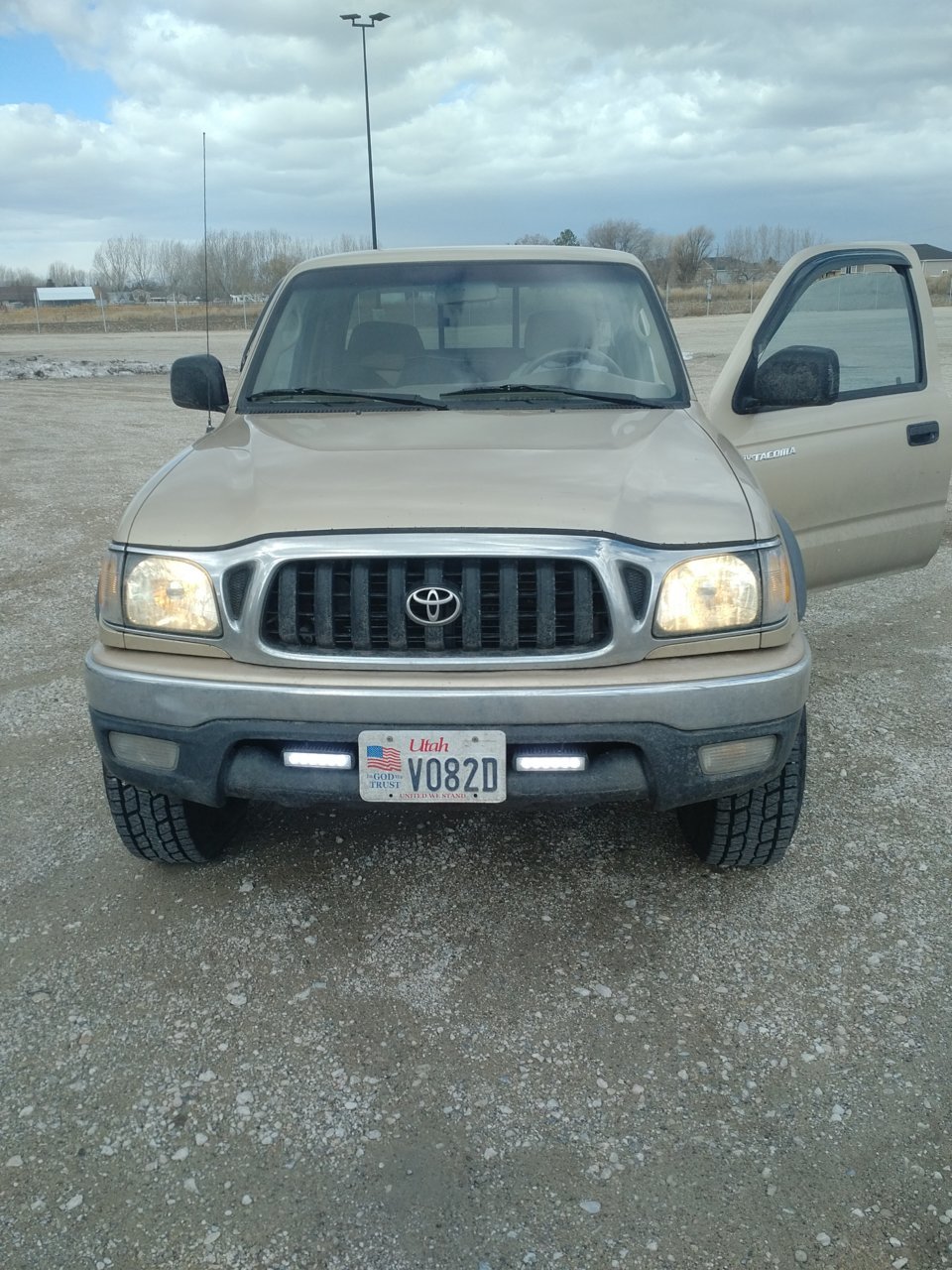

    I upgraded mine, they look like this now.
    IMG_20180302_1031128.jpg IMG_20180303_1121449.jpg Catinbow H4 (9003, HB2) LED Headlight Bulbs Hi /Lo Beam 7200LM Super Bright COB LED Headlight Bulbs Conversion Kit Plug & Play Automotive Headlamp Bulb 6000K Cool White (2 Pack) https://www.amazon.com/dp/B073JFP2HR/ref=cm_sw_r_cp_apa_i_fMM5AbZVHAKKC

    Definitely not an upgrade. I’m taking it you missed this link earlier in the thread:
    https://www.tacomaworld.com/threads/why-leds-should-not-be-run-in-halogen-reflectors.454371/

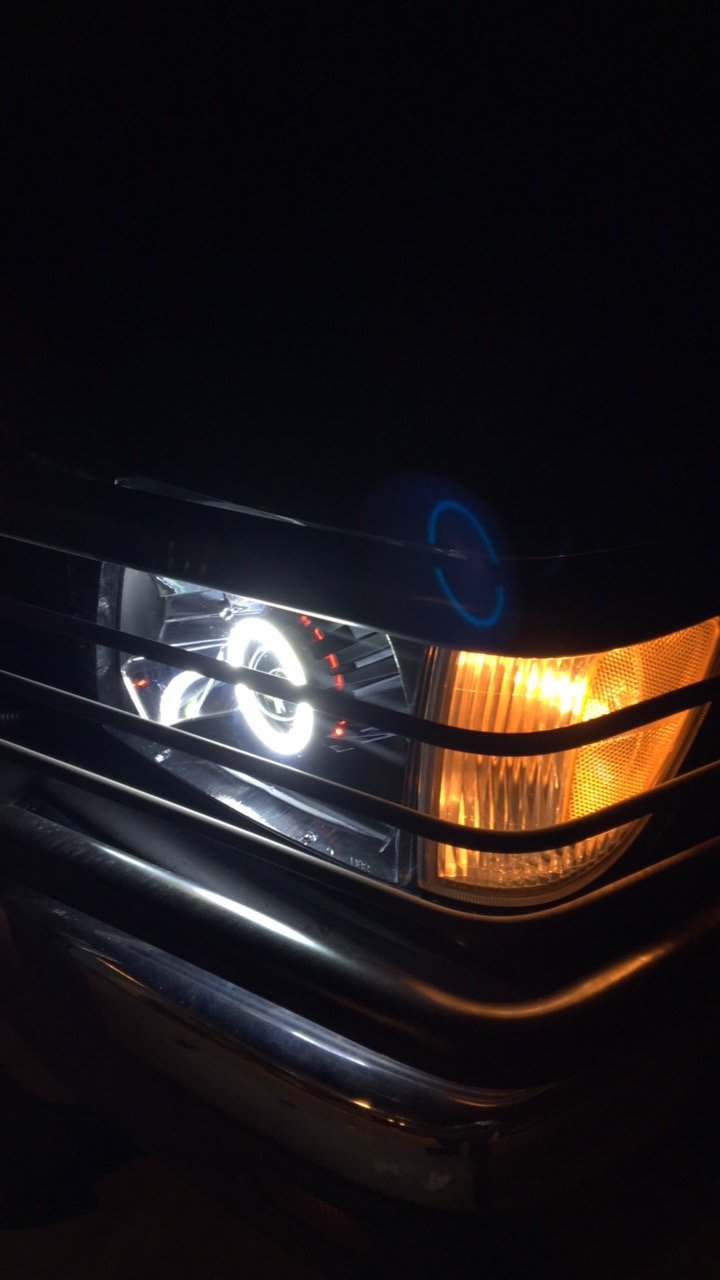

    I’m running custom retrofit headlights with:
    • ACME H1 HID's
    • 6,000k Bulbs
    • 90mm Morimoto XB RGB Rear-Mounted Halos
    • 80mm Morimoto XSB Switchback Front-Mounted Halos
    • Gatling Gun 2.0 Shrouds
    Really makes the look of the truck, and the light it throws is great. Retrofits are rather pricey but if you’re going for performance over look, proper Halogen or Xenon bulbs in the stock housing is the best way to go. Avoid LED.
