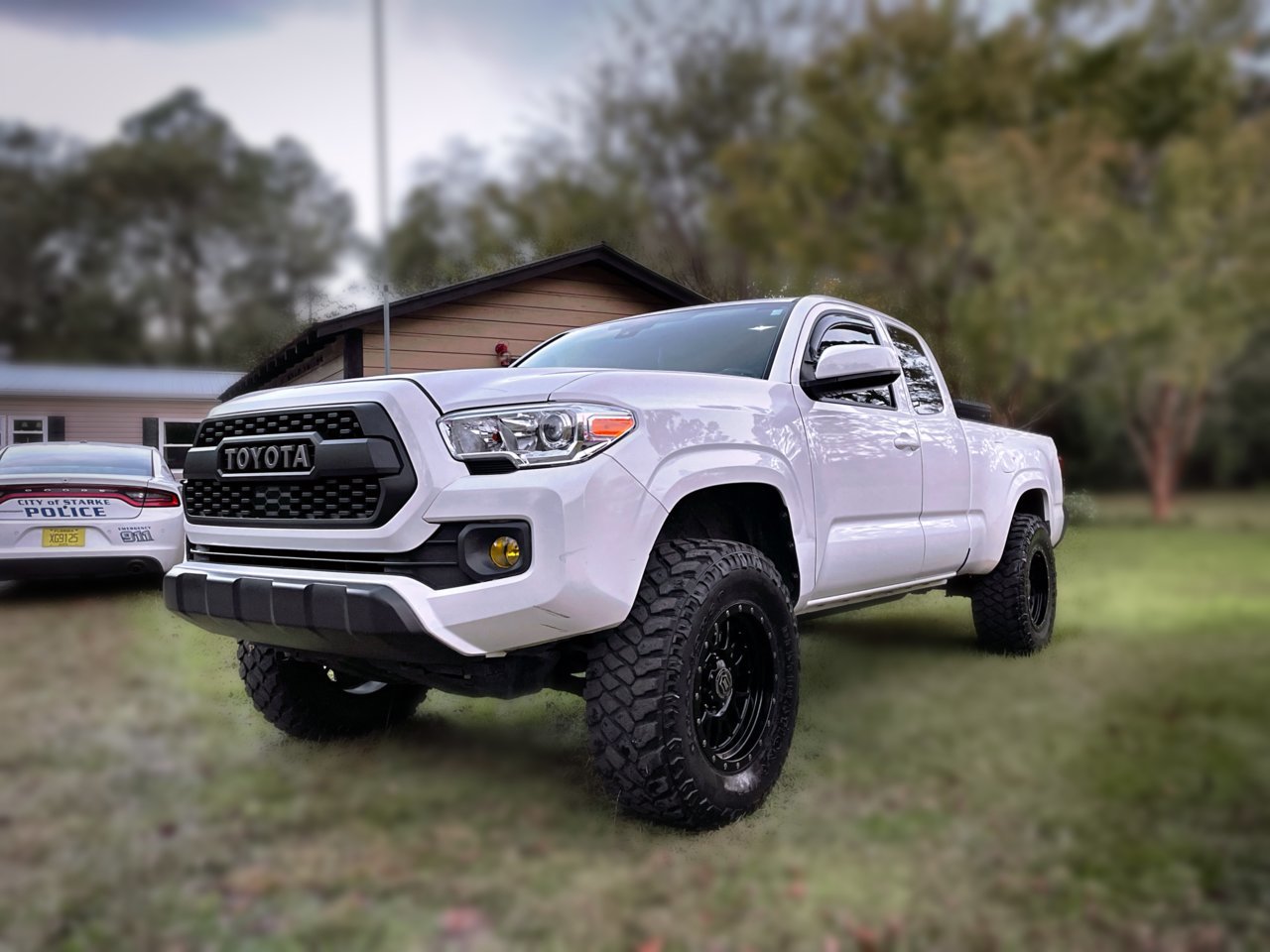

    2EA7BCD8-2369-4DB8-BF8E-8DB754555231.jpg Hey guys! Im looking for advice on my headlights.
    I have a 2019 Sr5 and I have a buddy who is giving me his TRD Off Road headlights and I know that it isn’t plug and play but I was wondering if anyone in here had a video they could point me to that would show how to wire them up or any advice that could be useful? Thanks guys!

    Back when I had my SR5 I was looking to do the same thing. The first question is whether you are getting the DRL style TRD Off Roads or the new LED ones.
    There are guides for both and also people have been making conversion harnesses.
    Harnesses:
    https://www.tacomaworld.com/threads/sr-sr5-to-trd-headlight-conversion-harness.728707/
    Guide:
    https://www.tacomaworld.com/threads/sr5-headlight-upgrade-to-drl-headlights-diy.577348/
    I believe those are both for switching to the non-LED TRD headlights with DRL. If you're swapping to LED, you can use the forum search to find those guides. They exist.
