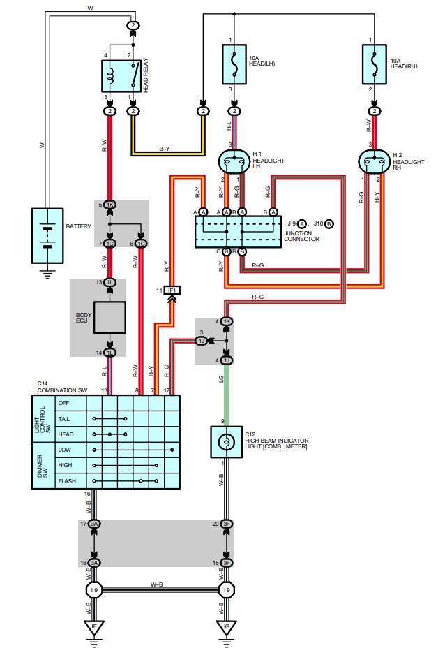

    I was asking on "flash" feature that would tur on high beams regardless is lights are on or off. As you can see on the diagram below, there are no fuses before head relay:
    The "Flash" feature turns on head relay (the clicking thing) bypassing any fuses and BODY ECU. So if by pulling the light stalk (to Flash) and relay does not click it is the issue between battery, relay, headlight switch or grounding of that switch. If that works, but turning the stalk by two clicks (from off to head) and relay does not click, then possibly ECU is blocking or contact 13 on the switch is bad (or the switch itself).

    Very useful, thanks for the diagram.
    I confirmed that the Head relay does not click in either scenario.
    Neither pulling the stalk (bypassing the body ECU), nor placing into the Head position produces the desired effect of engaging the relay (no clicking sound).

    Well... I found the problem and I'm gonna blame the nut behind the steering wheel. My Tacoma is low on miles and pretty much stays under street lights around the I-5 corridor between I-90 in King county and Hwy 2 in Snohomish county. Apparently I allowed BOTH of my low beam headlights to burn out without noticing. If you look at the schematic above, shared by RysiuM, you will notice that if both low beams are burned out the high beams will still work, but the high beam dash light will not. I ordered a couple Bosch 9003LL (long life) bulbs to replace them. :facepalm:
