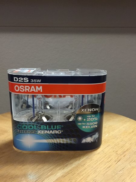

    Before I installed my HID Retrofits I was running HID's in stock housings and everyone was flashing their lights at me! In stock housings they create light spray and the light beam is not focused anywhere. It's all over the place. HID's are bright but I've seen some LED's that are brighter. The difference is, the HID's shine farther down the road. The LED lights shine really bright, but not as far down the road as the HID's do. I use my light bar for my high beams. Although I do have high beans too. And my HID's are very bright but focused since they're inside of a projector housing. I use 5500k OSRAM d2s bulbs. Here is a picture of the bulbs I use in my retrofits. Retrofits aren't that expensive to build. Just very time consuming like @Biscuits stated.
