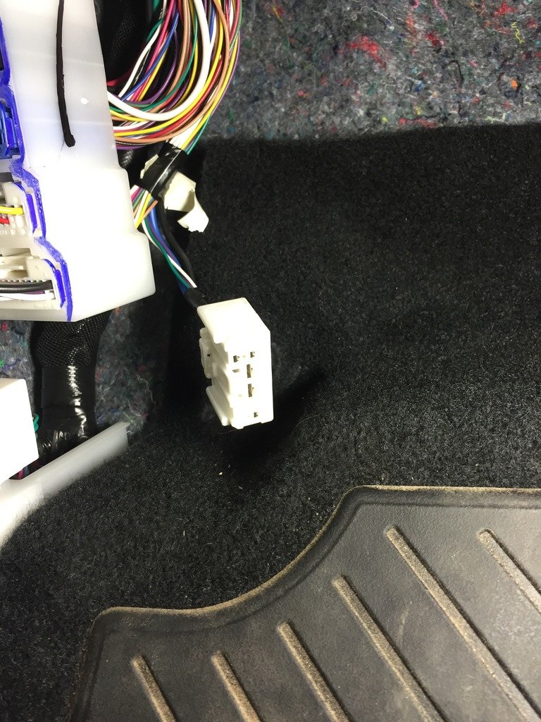

  12. May 27, 2016 at 8:06 AM
    Mike330R
    Mike330R Well-Known Member
    Jun 23, 2011
    #58757
    4,110
    Far West Phoenix
    '16 DC Offroad w/ stuff
    Brake brake plug is what I used to tap into. It's down by your left foot. I forget which wire it was at the moment.
