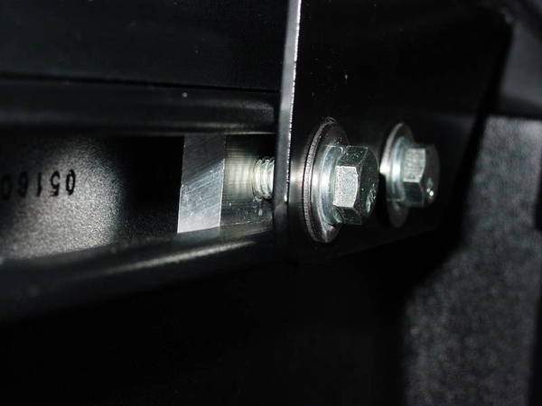

    Here is a pic of my jack set up, now there are others here. As for a pic of the set up, sorry I just re-installed my cover, (long story) but the alum blocks fit in the rail (firm with little play) and I would say they are about 1/4" thick, and roughly 2" long, the bolts are roughly 1 1/2" to 2" long and are 1/2" (socket or wrench). I should have them in a few days, and as soon as I get them (will be hunting) I will post pic's

    Well tried to cover some of the bases.
    Here is a pic of the bolt and alum block "installed" on the bracket and rail.
