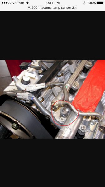

    IMG_3652.jpg Yup you left the temp sensor unplugged. If it's a v6 it's in the Front center.

    Thanks all!!!. Yes, that is where its located. Its definitely plugged in. I even tested the circuit and it was fine. I just ended up taking it to the stealership. Let them fix it. I do appreciate all the feed back. The valve cover gasket redo was fun!!!!!.

    That sensor has 2 wires, so it's probably the temp sensor that the computer uses. The sender gauge for the cluster only has 1 wire. It grounds itself through the engine.
    bjd1020, you need to find the correct sender gauge, the one with 1 wire. And don't give your money to the stealership!

    Ahh in that case it's in the back of the engine in the center near the firewall. Very easy to have been left unplugged or torn out of the connector during valve cover removal.

    Yeah, I have located that one. The one in the front that wht95scort has pictured above, its definitely plugged in. From what I have read above the one that controls the dash board cluster is in the back. I have yet to locate it. I wonder it removing the plenum would help locate it.

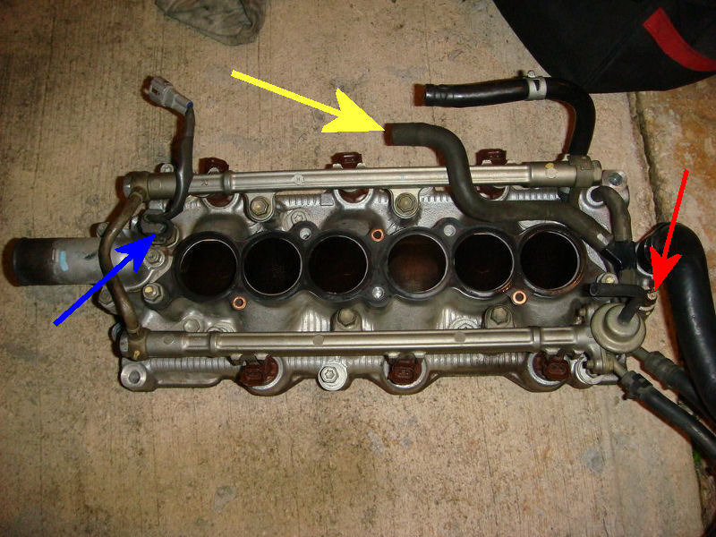

    AIRASSTTEMP_zps4kb84dg5.jpg should be the red arrow location
    On the 6 cyl, it's a little white plug next to the heater hoses at the back of engine. It's a single blade connector. It can be hard to see with all the hoses and wires back there.

    its a 6, awesome thanks for the photo. I will have a look tomorrow and see if that one is disconnected.

    I found the connector!!! it was right where you pointed it out and I had missed it. Connected it and boom, the gauge is working. Thanks!!! Where do I send the beer. One thing I am not too happy about......I spent 30 bucks on a Haynes manual.....while it mentions the sensor in the front of the PC, there is not mention of the dash sensor located in the back......
