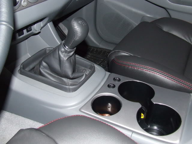

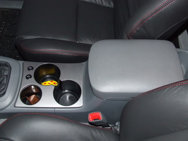

    Chris, Tim, I have the 6 speed trans and want to relocate my heated seat switches to the console. I see both of you guys were able to do it. I had taken my truck to a local shop to see if it could be done and they gave me a lot of BS about needing the wiring diagram to see if it could be done. Needeless to say they will never get a recommendation from me. Anyway what did you have to do to install the switches to the console. I was afraid there would not be enough room for the switches untill I saw your installs. I know I will have to extend the wiring to reach the console, but how did you run the wires? Did you have to take the console out or did the top of the console just pop off?

    I just ran the wires from the seats under the console to the switches then up past the shifter to the dash then over to the fuse panel. Can't remember if I had to add any length to the wires (I don't think I did)
    And the console has two bolts in the bottom that you can unbolt and take out then the cup holder part can also just pop off if you pull up on it.
