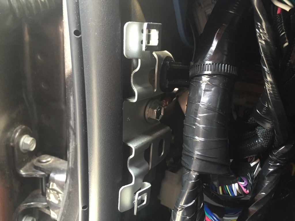

    I've had a member confirm no good ground in his driver side door. That would make this the second occurrence. I'm working with him to confirm a couple of details but will be making a change to instructions for the listed ground points on the mirrors.
    The good news is I've been sending out the early kits with longer ground cables that can reach into the cab for a solid ground point.
    It's a bit odd that most trucks are fine grounding in the door and a few aren't, but I'd like the install to be bulletproof for everyone so I'll adjust the recommended ground location to an area that should work out well for every truck.

  5. Aug 2, 2015 at 11:27 AM
    #345
    Duck76
    Duck76 Active Member
    Oct 1, 2013
    #113633
    44
    British Columbia, Canada
    13 Tacoma TRD Sport DCLB
    I just finished installing the kit. Packaging was great and the quality of the harness was first rate.
    I was one of the people who did not have continuity between the door and the cab so I grounded the circuit on the kick plate bracket inside the cab. Everything works great!

    I've always run above, but if you have a clear path there is really no reason why you can't run below. Also I'm going to be changing the mirror ground locations. If you haven't already done the mirror wiring I would recommend testing your ground first. If you don't have the means to do so then the ground location in the post right above this one is a great grounding point to use for the two mirror ground cables.

  11. Aug 2, 2015 at 4:59 PM
    #351
    Up2NoGood
    Up2NoGood [OP] Well-Known Member
    Jun 23, 2014
    #132511
    3,302
    Jaimes
    BC, Canada
    2014 TRD Sport DCLB
    Yes and yes :thumbsup:
    I purposely sent the early kits out with long enough cables to reach into the cab and ground to a point behind the kick panel if needed. It was a bit of a back up plan I case the extra length was needed and only started doing that because one of my installs had a bad door ground. Now that there has been a second truck with that problem I think it will be best to keep supplying the longer ground cables and adjust the grounding points to the position that duck has shown in his picture. I've tested that point before and it is a solid ground.
