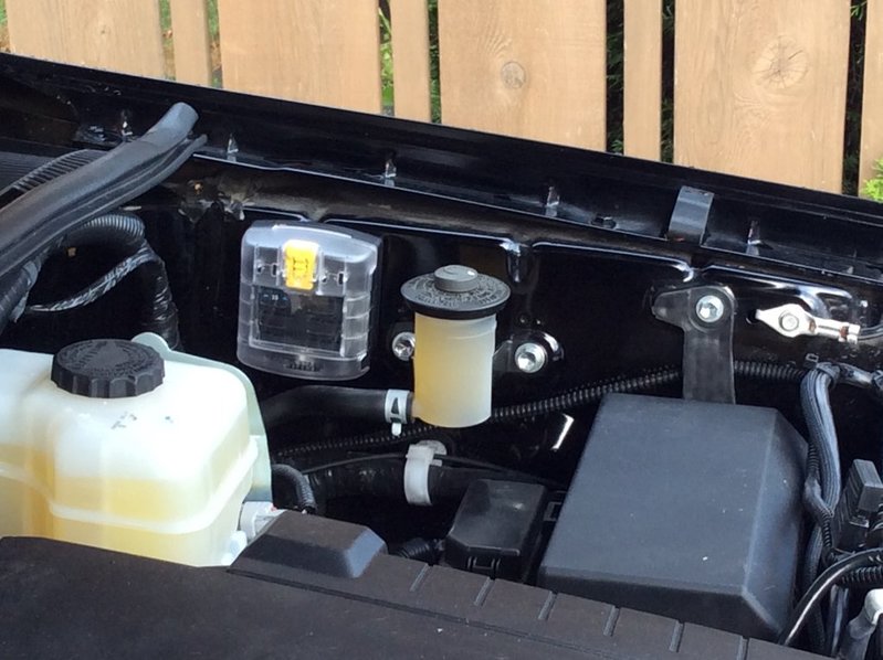

    My plan, so far, is to use this aux fuse box that is mounted but not wired, and find a nearby spot to mont a plate with some relays nearby.

    Yes that makes sense. If you are heart set on using a relay under the hood then I could probably make a modified version of the harness, but it would be an extra cost. Unfortunately some things like that burn up some decent time in reconfiguring it. There is also a possibly hurdle of actually running the wiring through the firewall. On one end of the harness would be a relay plug / connector and on the other end would be the female switch connector, I have my doubts that either would slip through any available openings in the firewall.
    Would likely need to have something such as colour coded bullet terminals so that the wires could be ran through the fire wall and then quickly reconnected.
    Some things to consider :)

    Okay well the easiest way would be to use one of your fused outputs to power the harness instead of an add a fuse. It could be done with one of your relays too but would need two wires at that point ran through the firewall, one to trigger the relay from the switch and the other to power up the harness.
    Also worth mentioning that to trigger the relay the switch provides a ground to the relay coil. Basically a to trigger a relay you need one lead to provide a ground and another lead to provide 12v. In this set up the relay has a constant 12v on one lead and the switch provides a connection to ground to trigger the relay.
    So I guess to make a long explanation short. It is possible to use one of the relays in your RTMR if configured correctly, but easier to just use one of your fused leads.

    Considering I am doing! I am now thinking...that I should use your kit as you build it, and keep the aux fuse panel for my fridge etc.
    I am just back from picking up a battery isolater as I have decided to run another battery. Upon reflection the heated mirrors belong on the starter batter side, the house battery side being saved for fridge lights etc.
