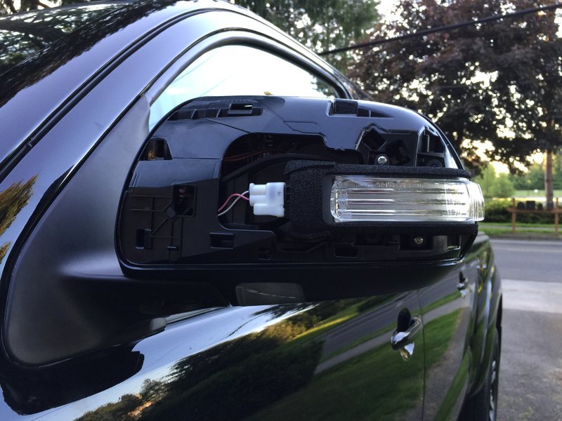

    Weather finally good enough (almost too good) to install my mirrors, should finish install today. Also installing illuminated ignition ring while everything is opened up.

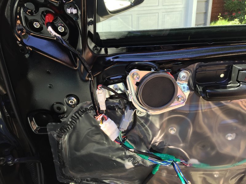

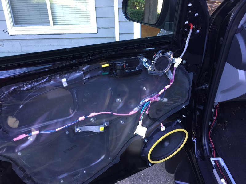

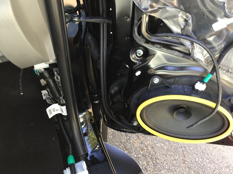

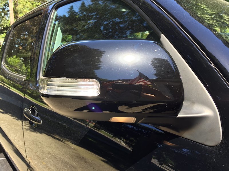

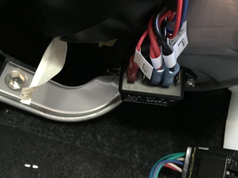

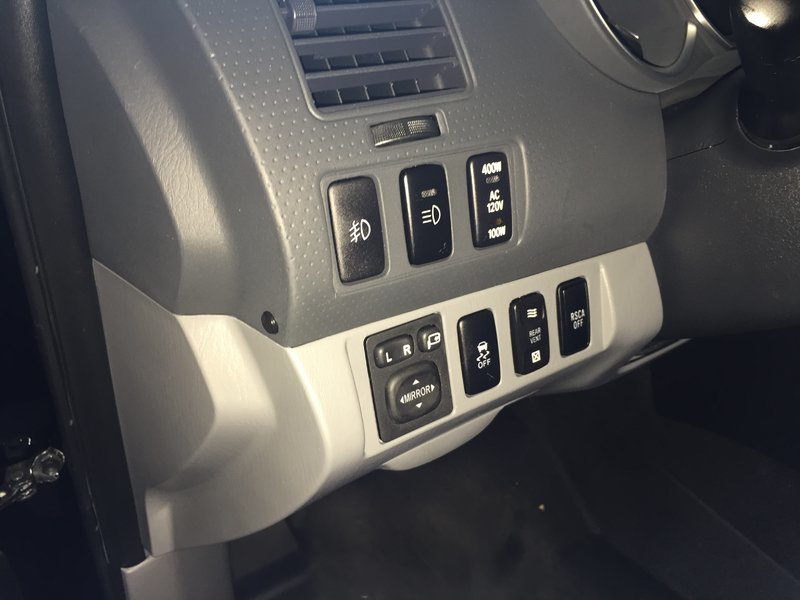

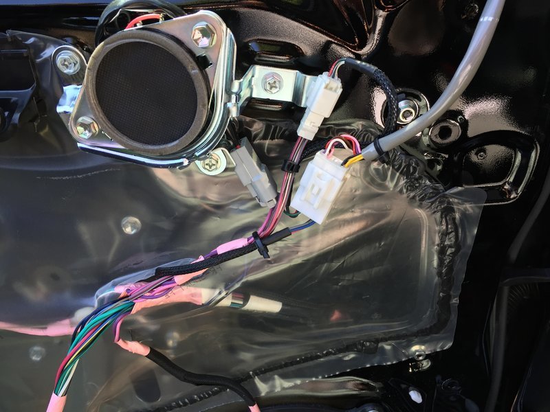

    Jaimes,
    Your harness worked flawlessly! Zero issues installing it. The instructions you sent were very easy to follow and everything worked great after the install.
    Here is my door opened with stock mirror:
    I used a piece of coax to pull the wires into the doors and across the cab:
    Here is the new harness installed in the passenger door, just make sure the lock tangs on the 4Runner mirror are flexed back to original position, mine were displaced from dis-assembling the plugs to take the mirrors apart:
    Driver door with new harness:
    Here is where I installed the relay, ground wire was installed after this picture:
    All done:
    Interior post install:
    Thanks again for the awesome product and support!!!

    Yes, illuminated key ring is also done:
