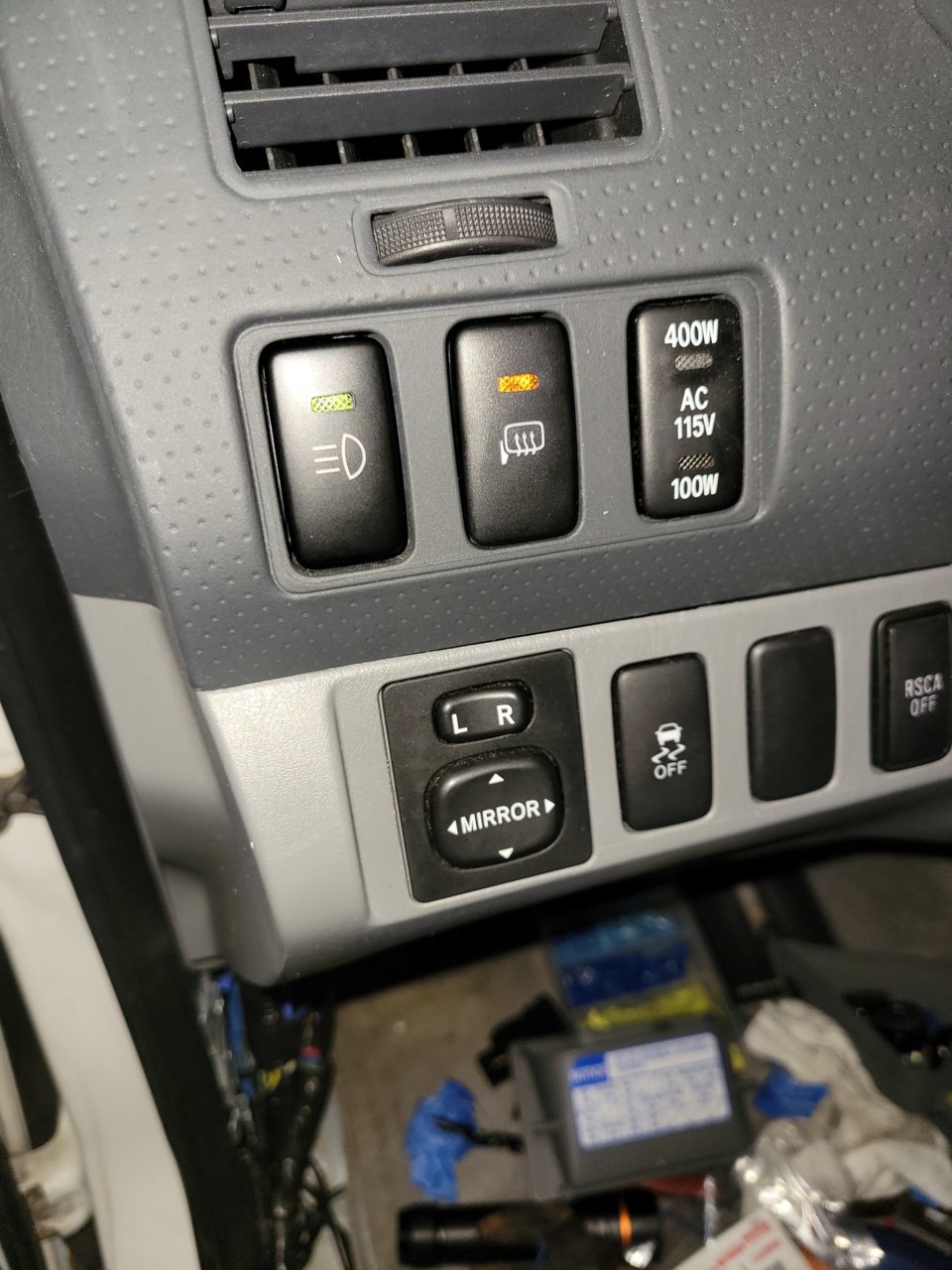

    This is a factory Highlander switch. It works and looks great.

    Looks great ! Now where did you get the mirrors and wiring !!

    Thanks. I got the mirrors, switch, switch connector and wires for the connector new from a Toyota dealer in Virginia, McGeorge I think. The miscellaneous wires and connectors I got from Amazon and the relay I had already. The instructions and parts list from this thread were invaluable to me. I used the heated mirrors today in the rain and I had nice clear mirrors while driving. It's gonna be great come winter. I spend about $300 or so on everything so it was pricy, but worth it.

    Great job! I would $300 to add them too as I need them all of the time from later summer to spring in the Northeast.
    Any chance you could provide the part numbers for the OEM Toyota Highlander switch and wiring? I would love to install the switch in the blank that is there for it. (baby steps: you have to start somewhere) :rolleyes: I like that lighted "on indicator lamp" fog lamp switch has too: Do you have a part number for it too? It makes me crazy that the factory switch doesn't have it.

    All parts needed for the heated mirrors including the switch is listed on the first page of this thread. You can Google the part numbers to find them the cheapest.

    The parts numbers for the fog light switch are pt297-35070-as for the switch and pt297-35070-sh for the plug and harness. I had to use a relay to hook the switch up because the stock switch uses ground as a trigger and the fj switch uses positive as a trigger.
