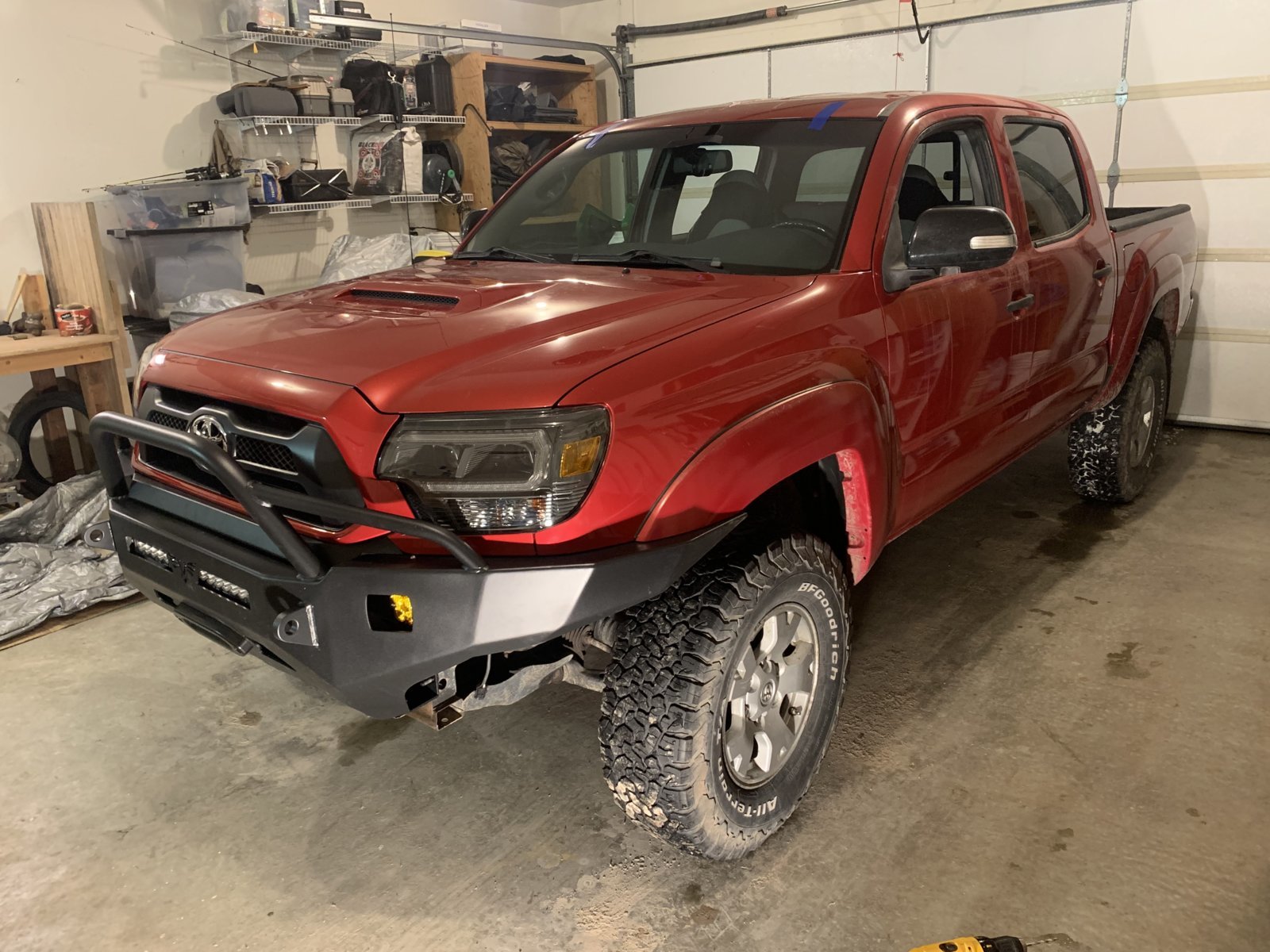

    I DID IT!!! But still need to finish the heaters. My 2009 TRD OR 6-speed now looks like a 2015 TRD Sport Auto.

    Wow... how hard/ what did you have to do extra (if anything) to swap the front end to 2.5gen?

    The hood, headlights, bumper, grill and mounting need changed out. However, if you're going to install an aftermarket bumper, you may not need 3 mounting pieces behind the grill. The Victory Strike doesn't require them. The front side panels are the same so no swapping there. There's a good write-up on here for the conversion.
