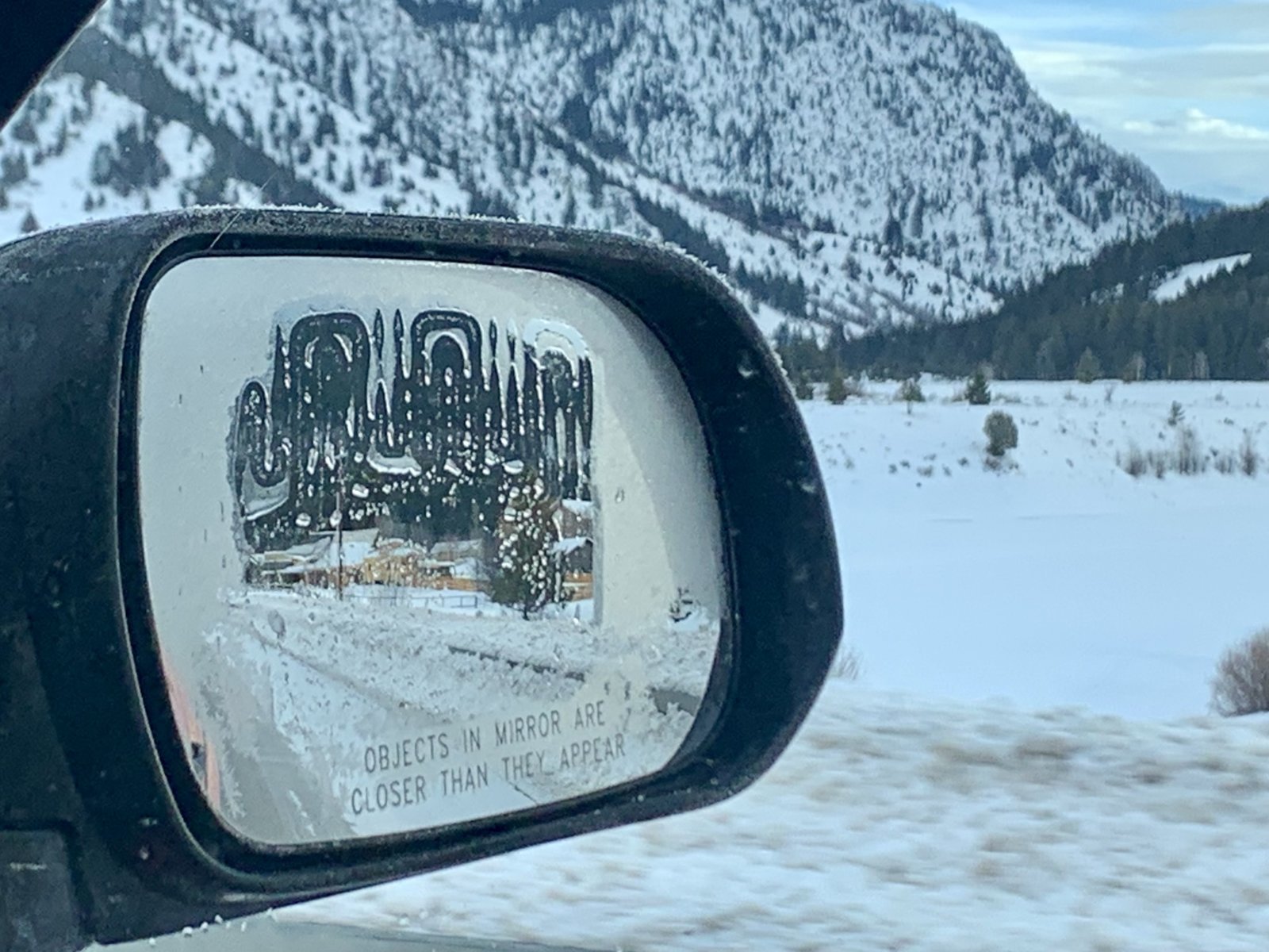

    Finished the heaters this last weekend. Turned out pretty clean but had to do some studying and pretty much get my YouTube University and TW degree to complete. Thanks to this thread and a few others! Turned out clean and I’m happy with the results. A snowball to the mirror melted off! Let me know if my album link to pictures doesn’t work. I just started creating albums and new to using them. I’ll make sure it’s not set to private.

    What timer or regulator did you use for the mirrors? I forgot if i posted photos of mine or not but have mine wired up with everything. the vled pigtail and wiring that came with the floor kits made the puddles super easy. I have wiring ran for the heaters but have not hooked up the heaters to power or added the timer etc.

    I did not use a timer. I wired power from an AAF in the cabin fuse box and used a click in/click out switch underneath the AC controls. For the backlight I tapped into the gauges fuse which allows the words on the bottom, half of the switch to stay lit at all times, however, it does not dim with the gauge dimmer, but I am OK with that. The top half that shows the mirror icon is off until I push the switch in. I believe I ordered that switch on Amazon

    ah ok cool If the switch should have 2 wires. For the switches in the AC controls, I believe green is on, and green/black is the dimmer. I recall you have to wire both one for power and one to dim.
    I may end up doing the same and just go on/off on a switch. Looks good. I have no free switches there but i got some ideas.

    It works… and fast too!
