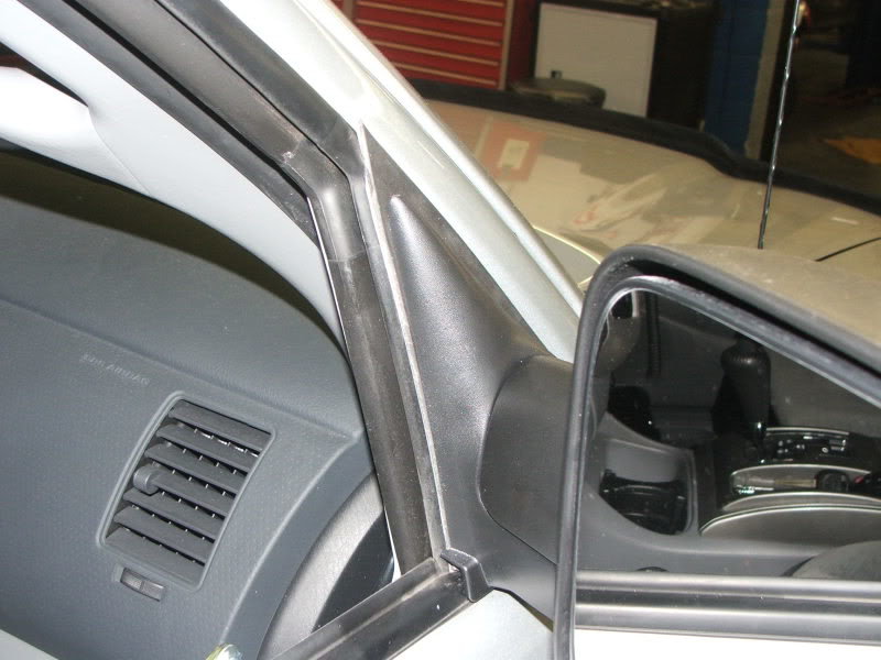

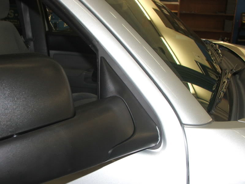

    O.K. guys got to work on the mirror mounting a little more yesterday at work.
    1. Due to the indentation behind the stock mirror I need to come up with a filler so these mirrors will have a flat surface to sit against.
    2. Also as you saw in the earlier pics the miss match up of the mirror to the door frame.
    I am in the process of making up some aluminum spacers to fill the indentation so the mirror will fit flat. Should have them done this week.
    Well I made up a rubber gasket that will hide most of the mismatch. I went to my local auto parts store and got some rubber splash guards. Then I made up a pattern and cut them out from there.
    Here is a couple of shots now.

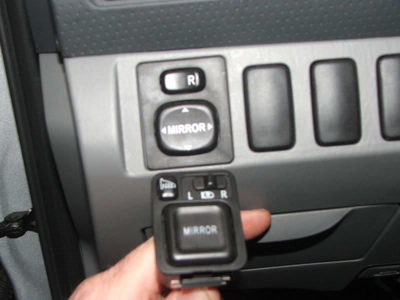

    The third thing is the stock appearing switch. The one I wanted to use is just slightly less wide. The first one I posted with the heat switch on the right side is the same size but I am not sure if I am going to use that one or not. Here is some comparison shots.

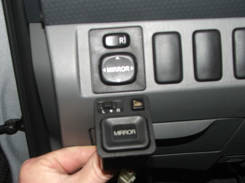

    And the one I might use.
    Have a few other switch options I am looking at. So bear with me.
    Should have the mirrors permantly mounted next week if everything comes together right.
    vince
    edit
    p.s. will have white mark cleaned off of mirror corner before permanently mounting. Used mark to sand corner to fit indentation.

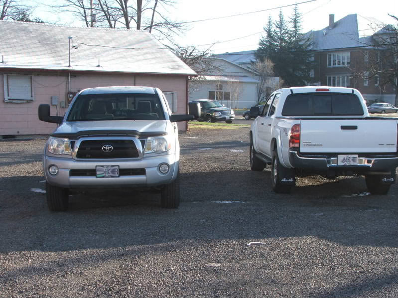

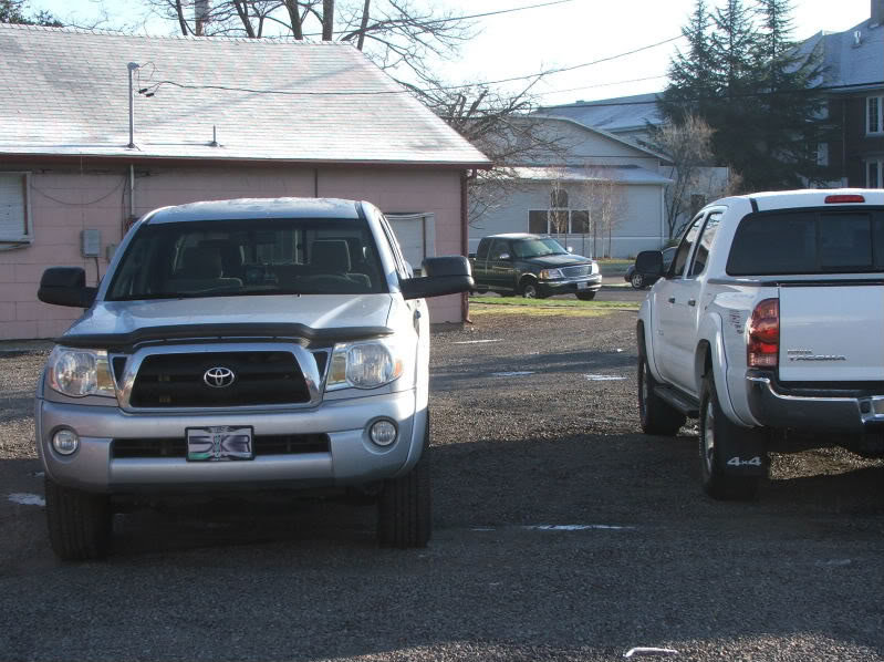

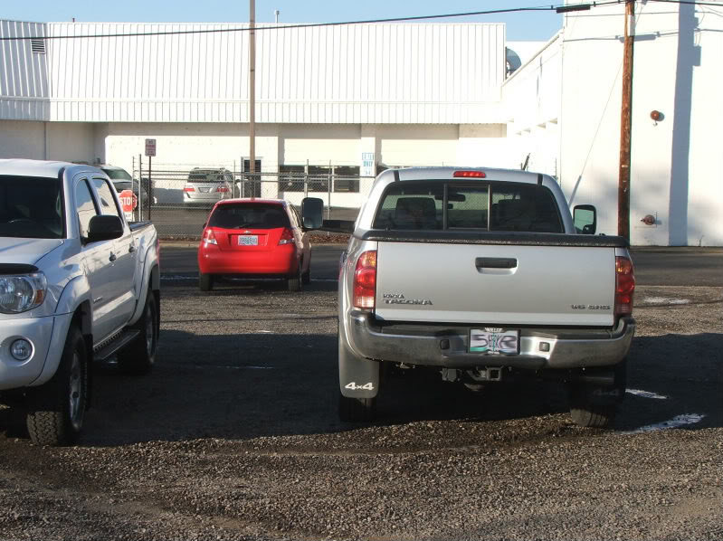

    O.K. now that I've got them mounted thought some of you might want to see them.
    But first a warning. The info I posted on the mirrors with a link to the dodge truck site, well the wiring info he gave for the mirrors might not always be correct for the mirror you purchase. One of the mirrors I got the common wire was blue and the other mirror the common wire was yellow. Any way if you do get these mirrors use a jumper wire from your factory connection at the door to the mirror wires to determine if they are working in all directions correctly.
    After mounting them at work yesterday I drove home 30 miles freeway and surface streets. They were stable as factory mirrors. This morning I put them in there extended position and drove to work. Stable as could be. No wind buffeting or noise.
    First shot shows them in normal position with another Tacoma beside it with the wimpy stock mirrors.
    Now extended you can see what an improvement in towing they will be.
    Any Questions?
    vince
