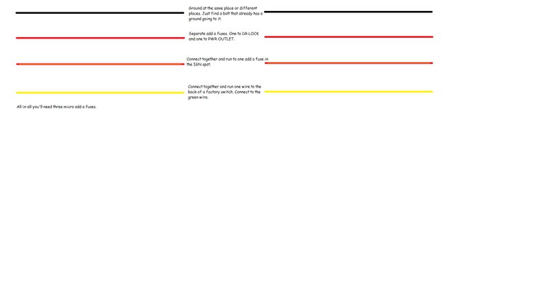

    It should have the same effect because that spot only has 12v when the dash lights are on. I'm pretty sure the LEDs in the switches are no dim-able. I think they're just on or off.
    The add a fuse for the heaters has no bearing on the factory fuse or vice versa. I would recommend a 10a fuse for seat heater wires unless otherwise specified by the instructions.
    Exactly.
    It's no problem at all. Anyone will tell you that I love helping other members whenever I can.
    That's one way. I just used a metal coat hanger and carefully ran it through the switch hole through the back. I used a flashlight from the back to give me a good location to go towards. Then just taped the plug on the hanger and pulled it back through. In the picture the arrow is where I fed the hanger to and also put the flashlight to help guide me there.
    Also here's a quick wiring diagram I drew up to assist in it all.

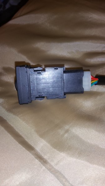

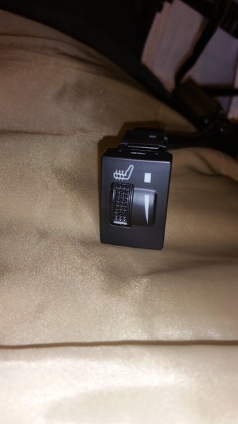

    I assume the get pushed in from the back. I have 2 switches...1 per seat. I will upload photos when I am home.

    No the switches get pushed on the face of the switch towards the front of the vehicle to install them.

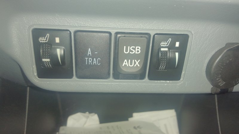

    Nice!! That should make the way your installed yours much easier for me...here's a couple photos of my switches. If I disconnect the switch and feed the wires in from the back (like you did) I can feed them through the empty hole, plug them back into the switch and and pop the switch into place.
    Which way to the blanks push out? Towards the seats or towards the front of the vehicle?

    Those are the exact switches I have. I'm pretty sure you have the exact same kit. Yea that's what I did. Unplug it and feed the wires, then plug it in. The blanks push out towards the seat. There's a few ways to remove them. You could screw a screw into it and pull the screw but then you ruin that blank. That's probably the easiest option and a new one is only about $5 from the dealership if you ever need it. Other options are to try to pry it out but you run the risk of scratching around the blank. I would just put a screw into a blank that you want to remove and pull it out. Once one is out you can push out the rest from behind with your finger.

    I was planning on just doing the add a fuse to the ACC fuse or GAUGE fuse. Would this not work this same? I do have the A-TRAC button under the AC controls...but I was really hoping not to splice/tap any wires.

    That will work just fine. I was just making sure I gave you all your options so you could make the best decision for your install. Feel free to pm me if need any help during installation. I'll be working Friday but will help if I can.

    I just wanted to say I installed these on Saturday. Man, these things are great!!!
    I found this write up very helpful https://www.tacomaworld.com/threads/center-console-removal-w-pics.57895/ as well as this video https://www.youtube.com/watch?v=BQI7oFzbups&index=6&list=PLtX0_zl4NAHFo_qSwgfVfOkrJq2Unozmc. I obviously removed the center console as opposed to running the wires from the floor. There was plenty of room to run the wires from the seats under the center console to the switches. I should've taken more photos. I did damage the area around the blanks :( because I thought I'd use a small screwdriver to remove them. I ended up using a large screwdriver after and had no further issues.
    When I removed the blanks and to my surprise there were female plugs behind the blanks!!! I also have a lot of wires under my seats...what are the chances my truck is pre-wired for OEM heated seats? Are OEM heated seats only on the leather interior? What are all those wire under my seats??
