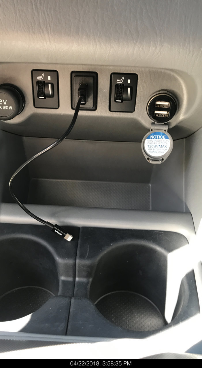

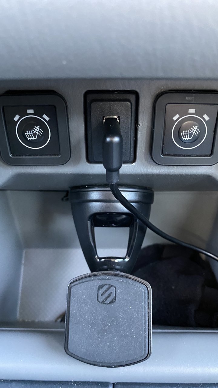

    Yes there’s nice kits for under $100 i put a set in my father in laws 2012 and i put a set in mine8899611E-5978-47D4-8415-ADBEA9ACD276.jpg8C73AE3D-DFDB-4B62-98BA-A9390F741D7A.jpg
