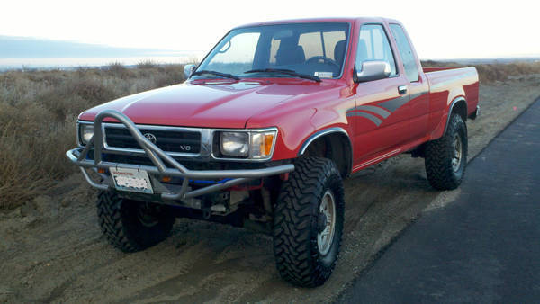

    Current Pic:

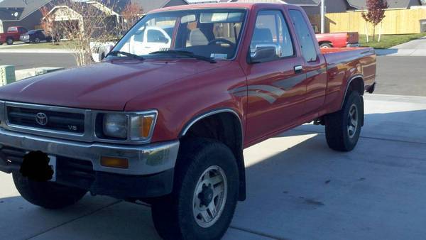

    Here is what it looked like when I bought it:

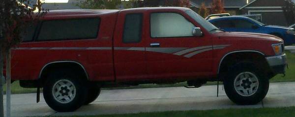

    First thing I did was remove the canopy. Then I washed it inside and out. Took out all the plastic inside and the seats in order to shampoo the carpets and get the 20 year old dirt out of it.

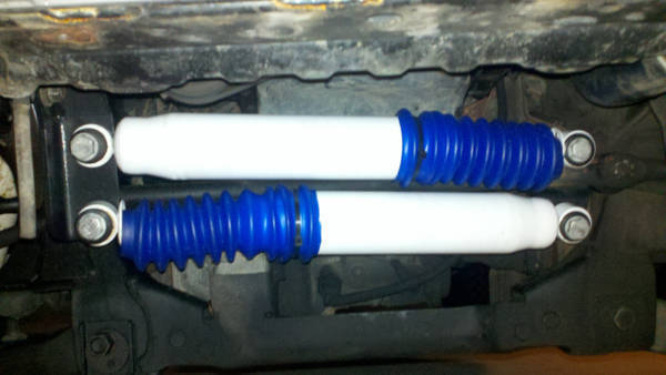

    Got dual steering stabilizer shocks:

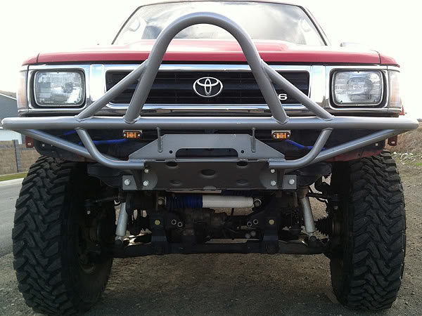

    Bought an Addicted Offroad stinger bumper and got it powdercoated. Finally got it on the truck:

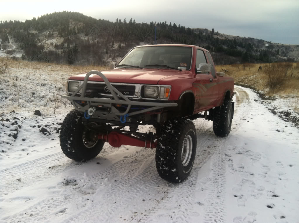

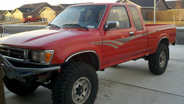

    Ordered a Rough Country 4 inch drop bracket lift today! Here are some Before lift pictures I took earlier. Hopefully I will have some After pictures in the next couple weeks!

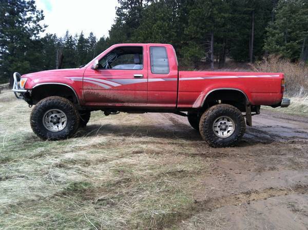

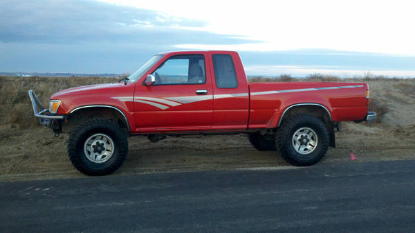

    Got the truck lifted a few weeks ago, but finally got some pictures of it.

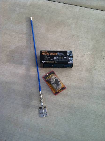

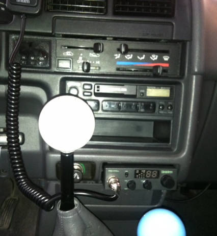

    Yesterday I installed my new cb radio! The install was pretty simple and it works well.
    And, a rear trail gear bumper should be here in the next couple days.

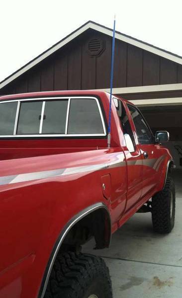

    I already managed to break my CB antenna in half... The good news is--The company I ordered my CB kit from, Right Channel Radios, sent me a new one out absolutely free! I'm extremely happy with their customer service.
    Here it is:
    Now I just need a good trucker name for my CB handle...

    The Rough Country lift works great. There are very few lifts for these trucks on the market. BDS makes a lift too. It is more expensive, but might be a better way to go. We had to do a bit of extra fab work to make the Rough Country work. The sway bar brackets weren't even close--so I just removed the sway bar for good. (I can't tell the difference anyway.) Some of the bolts were only grade 5 and I wanted grade 8, so we had to make a few trips to the hardware store. Also, the kit was missing some of the bolts. Some of the directions were out of order, but it worked out OK because I was easy to catch where the problems would have arose. In short, the lift looks good and seems high quality, but the fit and finish of the install wasn't the best.
    As for the dual steering shocks--I love them. They make it so that the steering wheel is much less jerky when taking the truck off road. On road, it makes turning a little more difficult. Overall I would recommend them though!
