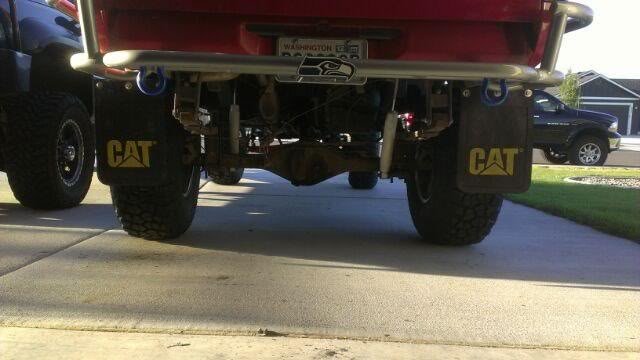

    Still no front driveline... But, I did finish up some other important stuff. Tuned it up with new spark plugs and wires and such. New fuel filter also. The truck seems to be running much better now. Also, mounted up some bigger mudflaps:

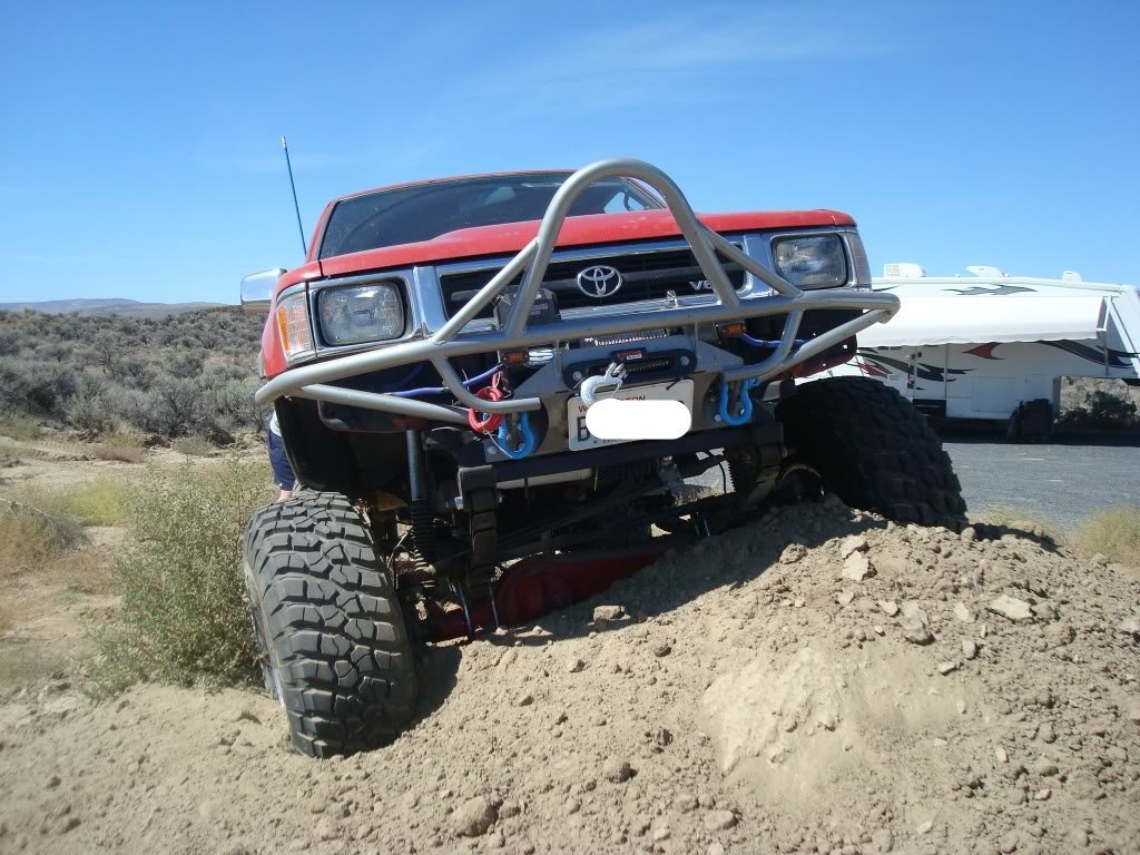

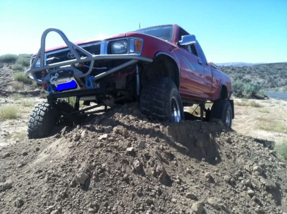

    Managed to get it stuck in some dirt this weekend! Lol
    0BCDF4C6-61A9-486A-BF73-DB5017EC49F2-219_7125d8708c3e7f196810ffbe6db62eb93a8b140e.jpg
    My plan is to build the front driveline next weekend.

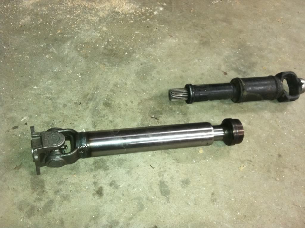

    I wish Trail Gear still made complete drive shafts... I have my old ifs driveline and the Trail Gear long spline kit. I'm going to work on it more today.

    haha yeah i agree but at least its pretty easy to finish it up with welding the old shaft on the new trail gear shaft. Cant wait for you to get her done!

    The welding isn't a problem... It's the cutting that was... Lol
    Anyway, took the ifs driveshaft apart and clearanced it according to this write up: http://www.4x4wire.com/toyota/tech/cvmod/. Broke and replaced a u joint. Taking it apart was a pain in the ass-- the u joints we're uncooperative and the needle bearings kept falling out. But, it is done and the angle is now increased to around 35 degrees. It's at the driveline shop now getting lengthened with the long spline kit. I should have 4wd soon!
