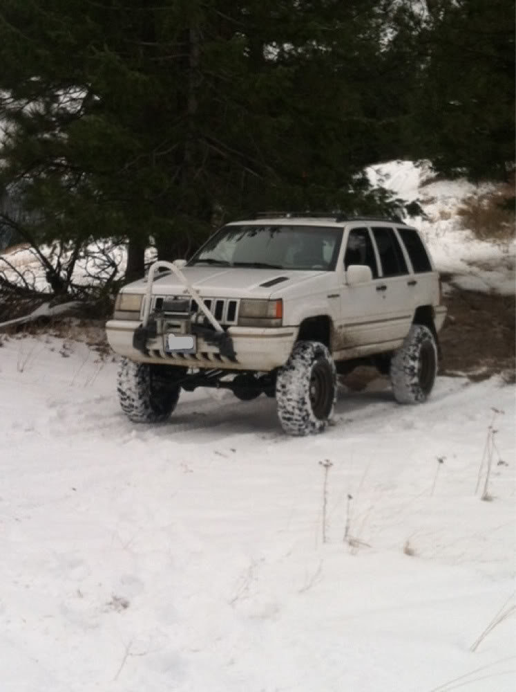

    Both are old pics..I need to get new ones. and both pics have 37's

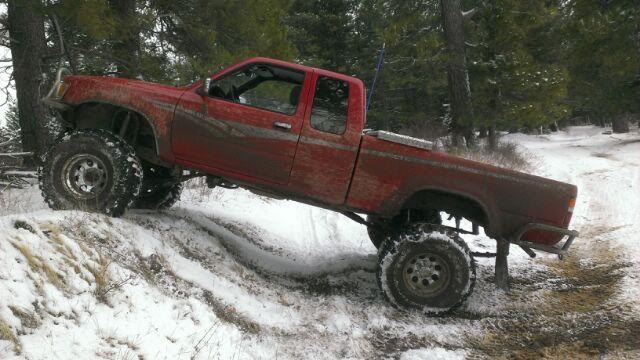

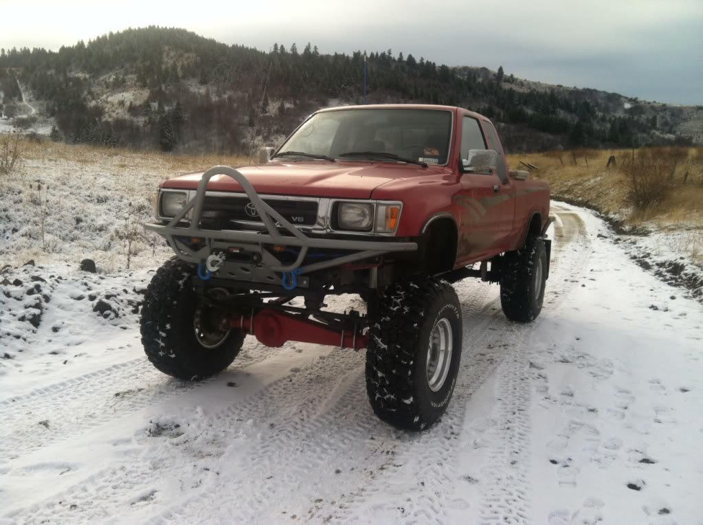

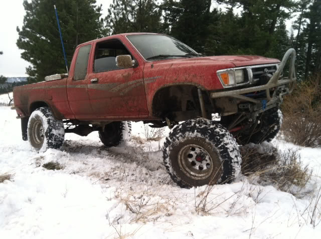

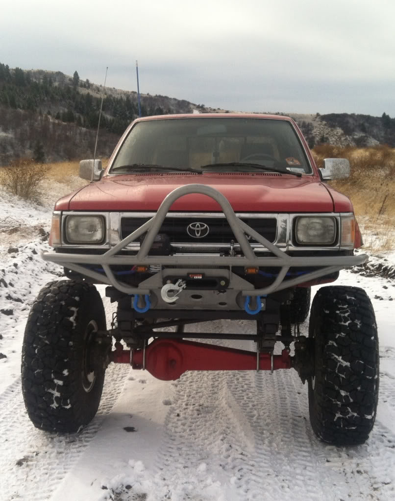

    Finally took the truck offroad to try out the new suspension:

    :yay: How'd it do?!?!

    Awesome! The rear locker might be the best money I have put into the truck. Destroyed a u-joint, but that wasn't a huge issue. It is much more capable than it was before the SAS!

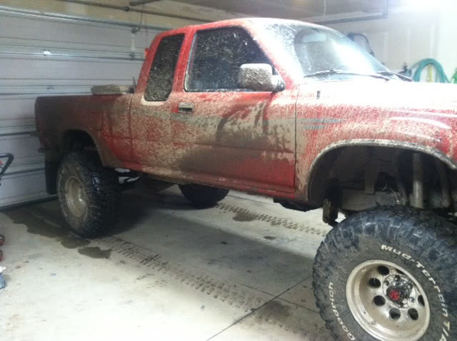

    Yeah, the rear locker made the mud puddles way too easy! I'm not certain how I destroyed the u-joint--Just started clunking on my way off the mountain. I think I probably just did a terrible job of installing the u-joint in the first place. I really don't want to deal with it, so I will probably just have a shop fix it (some things are worth paying for... LOL.)

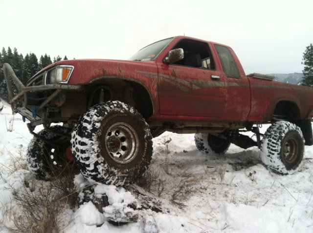

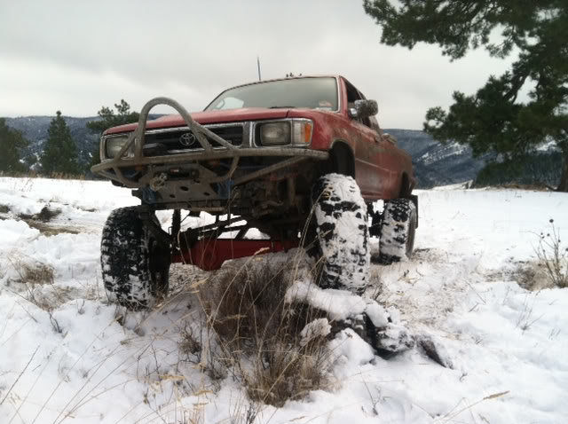

    Two more pics... But, that's all I got... :D

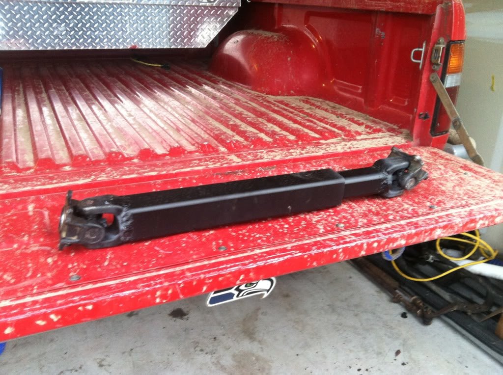

    New front driveline:

    Looks strong. :cool:
    And seahawks... :thumbsup:
