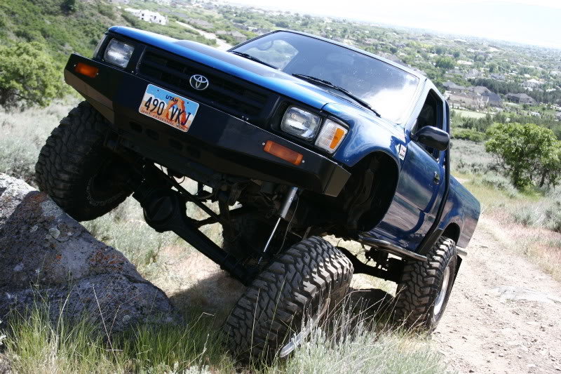

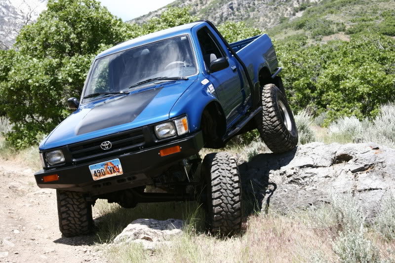

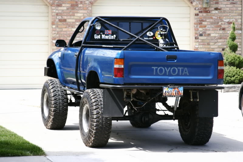

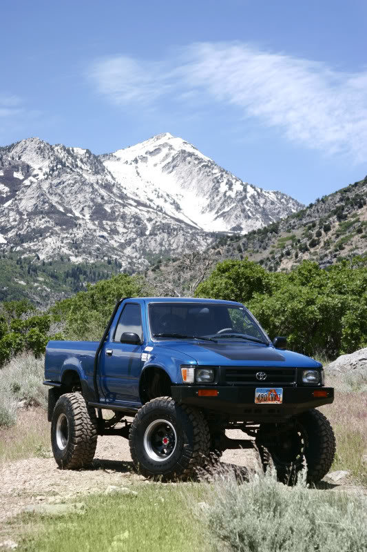

    Nice build! I had a '93 reg cab and LOVED it. The SAS and crawler made it totally awesome in the rocks. These are really great trucks and I'm sure you're gonna have a blast with it.
    Here's how I had mine set up.

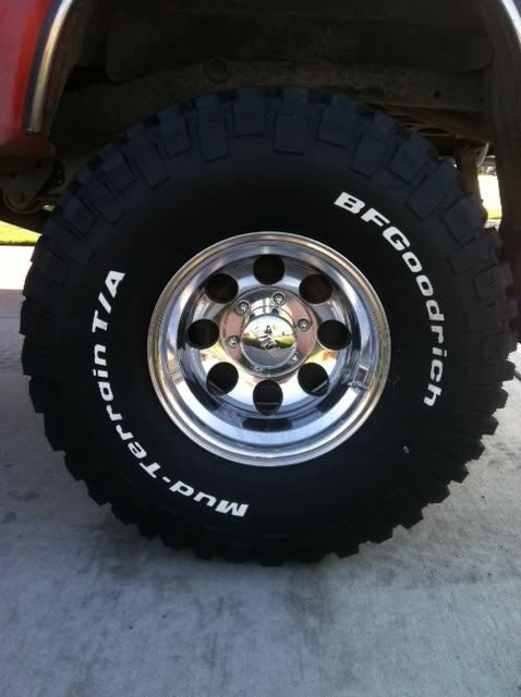

    New 35x12.5x15 KM2s on MT Classic II's!
