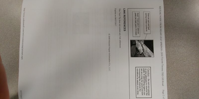

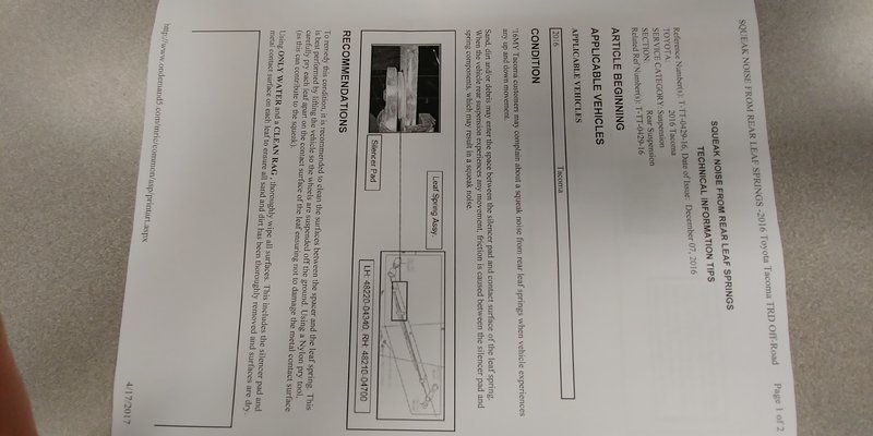

    Toyota has a tsb for it. I seen it but don't have the number for it I belive they clean and lube the bushings. I'll get the number for it when I get a chance when at work.
    Hope this helps some
