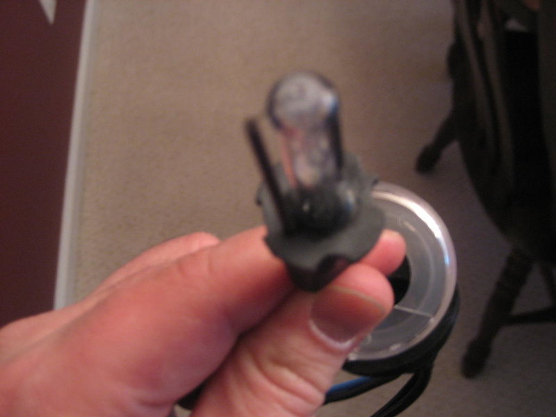

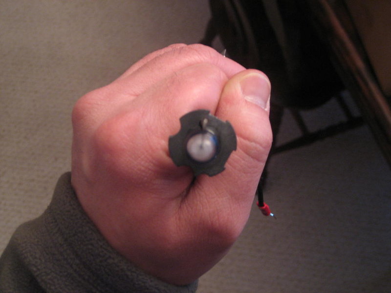

    My bulbs only "fit" at a 45 degree angle to be able to use the tabs on the housing. I was thinking of using a dremel to make them fit. Any suggestions? I have the H3 kit from DDM, but they look different then Klipps. If I don't put them in at a 45 degree angle which side should I put them, blue post up or down? Hopefully it doesn't matter, that way I'll just put them in how they fit best.

    ^^ you shouldn't need to use a dremel to make the bulb fit into the light housing. just line up the round and flat grooves on the base of the bulb with the corresponding tabs on the hella light housing. if it doesn't fit, it's not an h3 bulb.

    Thanks Klipp, I realized I was looking at it all wrong. It fits just fine, let the modification begin!
