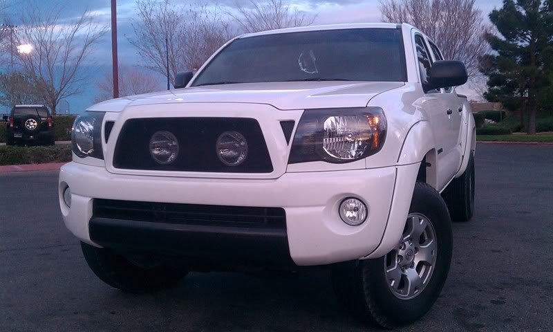

    Just finished mine. Using your write up (which was great btw), as well as your same measurements for the light mounts. Love them, hope to go HID with everything soon.
    One question. My 500's sit flush against my grille. They don't bulge it out at all, but I was concerned about heat issues with the lights/grille. Can I melt my grille finish, especially when I go HID?

    ^^ i wouldn't worry about it. i've been using mine for over a year without any issues. the gc still looks perfect.

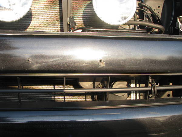

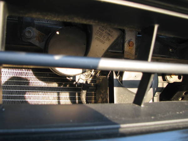

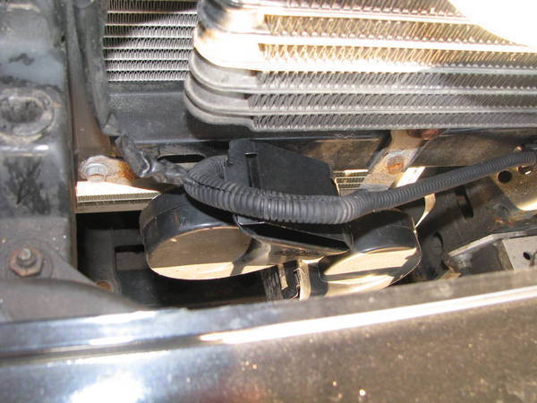

    Where did you end up putting the horn? do you have a pic?

    no pic right now, but i'll post one on the weekend for ya

    here ya go

    Could you have just mounted the horn on the aluminum bar that holds the HELLA lights? I am doing this upgrade this weekend

    i wanted to have them mounted out of sight. cleaner imo.

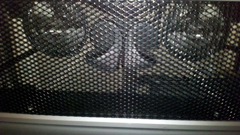

    Took awhile to come up with this solution...
