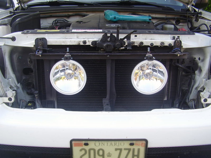

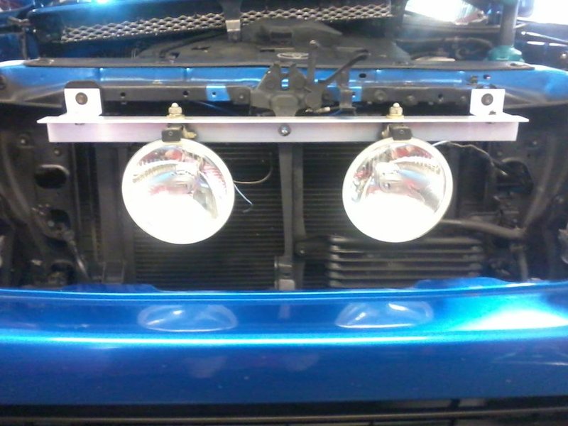

    so I stacked 2 pieces of aluminum for strength...no bounce now, but there still is a bit of a jiggle when I go over bumps...will probably replace the mounting bar when I convert to HID's...
    Thanks again for taking the time to do this DIY tutorial!
