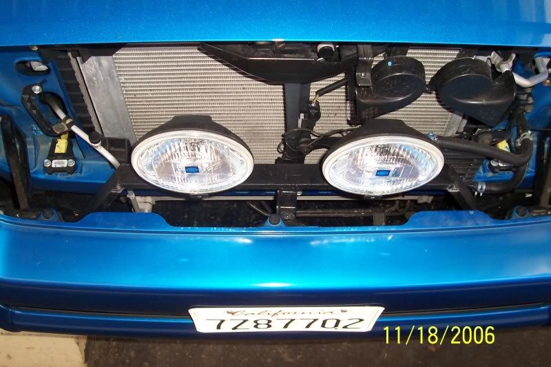

    Subb'd for near future reference. Great work on the conversion. Of all the behind the grill set-ups, I have not seen one done like mine.
    Talk about over thinking shit. Your idea is way easier!!

    haha, your mount looks solid man, but yeah i wanted something i could just pop on using the pre-existing bolts without having to weld

    Made a mounting bar identical to yours. Only using the two outer bolts though..
    Have these mounted behind my stock grill right now, until I satoshi it.
    Also did the same switch method, with the 12v wire hooked to an add a fuse under my dash, so the lights are on with ignition only. Although the light in my switch doesn't work.

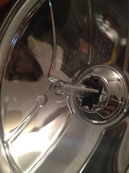

    great write up! I just finished converting Hella 500FF with the DDM Tuning 55w 5000k slim kit. I tested before epoxy and they are blinding...can't wait to complete the install on the truck tomorrow. It took almost 3 weeks for the HID's to ship to me all the way from China...not from DDM's address in San Diego. My ballast look identical to the OP but they don't have DDM imprinted on them.
    A bit of advice for those converting....careful with the epoxy....on one of the lights there was a big enough area for epoxy to drip through around the bulb and it leaked into the housing that is sealed. See below:
    Here's the good one....
    Snug like a bug...
    Here's a drop of epoxy that slipped through the tiny areas around the HID bulb and the reflector housing...

    ^^ Good post. Weird about the shipping from China part, mine were shipped out of Cali :confused:

    Ya the product looks exactly like yours except the ballast don't say DDM on them. In the future I'll call DDM Tuning and order over the phone and see if they have the kit "in stock"....like in California haha :p
    That single drop of epoxy drives me nuts but with them behind the grille I might forget all about it...I'm thinking of spacing them out a little more too but was trying to see how it'd work with them between the vertical bars in the grille.

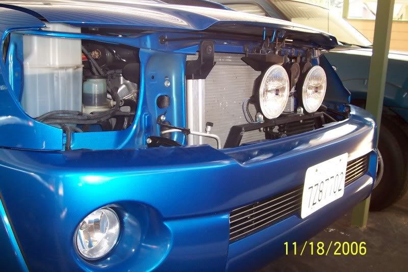

    Thanks again for the great write up...without detailed pics I would have probably not attempted to convert the Hella's to HID and mount behind the grille...but it was so easy!
