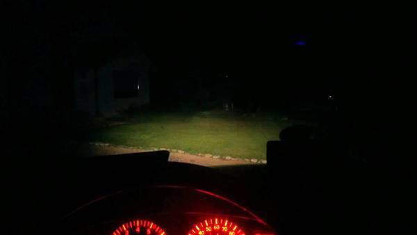

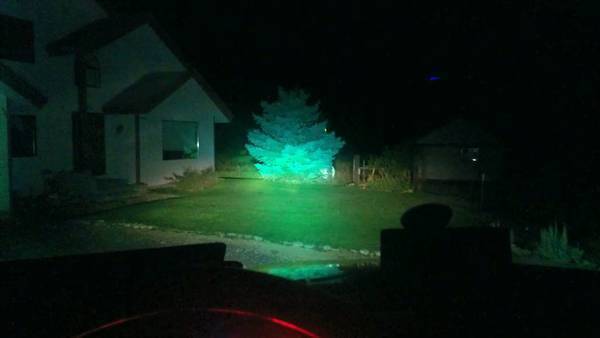

    Here's from inside looking out...
    Just low-beams:
    Just high-beams:
    High-beams & HID Hellas:
    My truck is slightly angled down in the driveway, but you get the idea! ;)

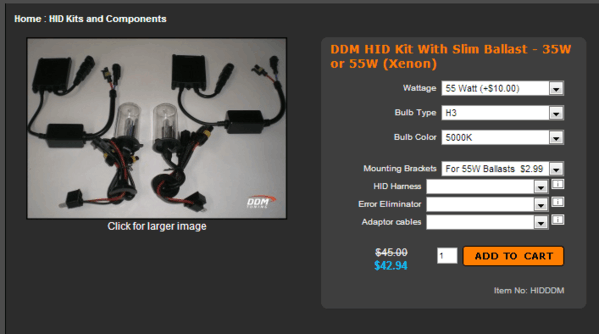

    super new to lighting is this what i need to buy?
  15. Oct 6, 2013 at 10:24 AM
    #355
    Gus 524
    Gus 524 Well-Known Member
    Apr 22, 2012
    #77417
    523
    Justin
    MN
    09 tacoma SR5 4WD 4-cylinder
    Anyome?
    55watt
    h3
    5000k
    And mounting backets for 55watt
    Is that right?
    Thanks

    Gus 524, that's correct. All you need to make sure is that it's an H3 bulb. 55w or 35w and color temp are your choice. I bought the 55w 6000k kit from VVME and plan on installing it soon!

    Thanks a million man. That's what I needed to hear.
