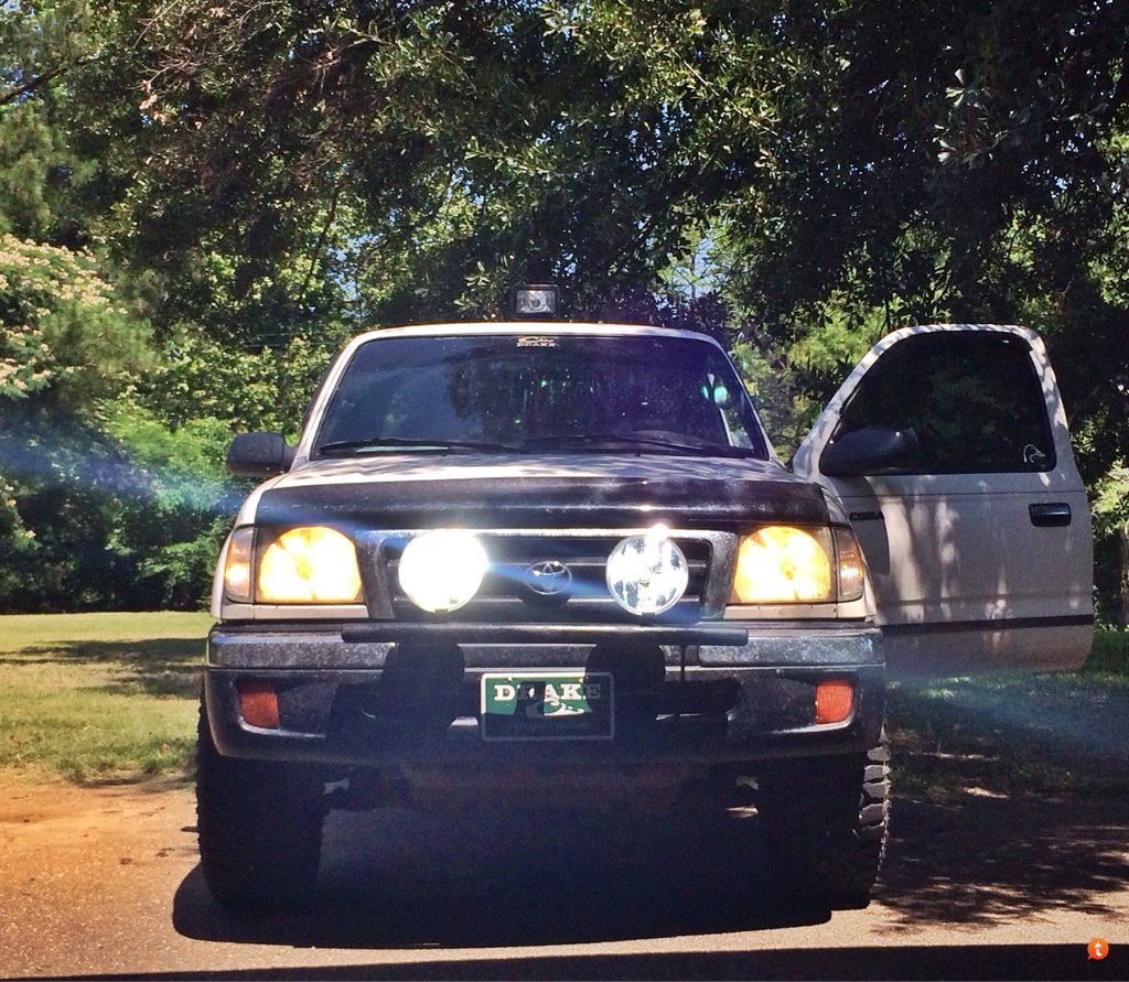

    I ordered some hella 700ff's and the HID Kit from DDM, and haven't found a wiring diagram anywhere.. Is this that I've drawn up far from accurate?

    It worked haha. Just finished like an hour ago
