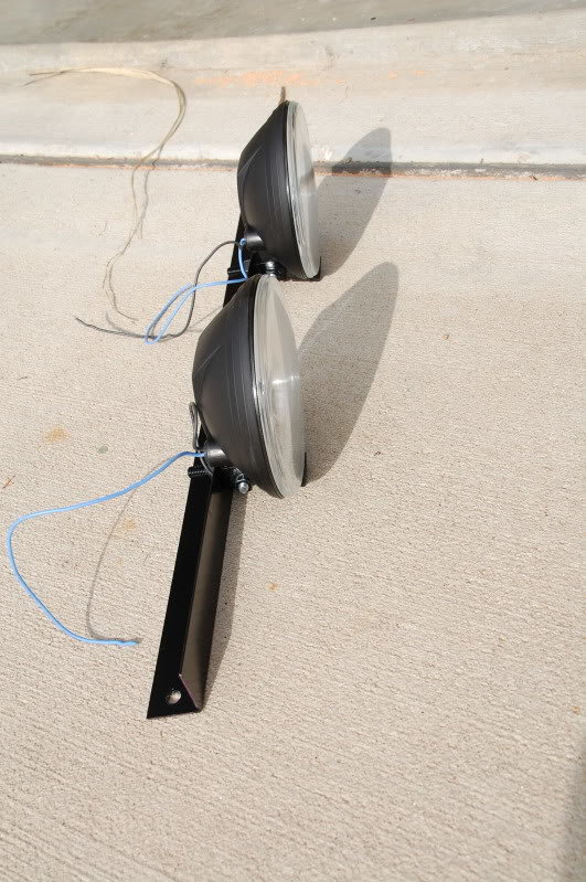

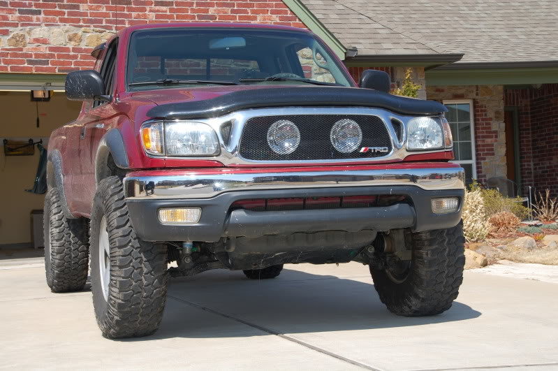

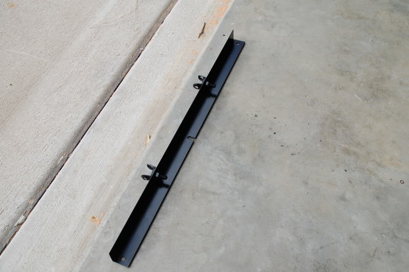

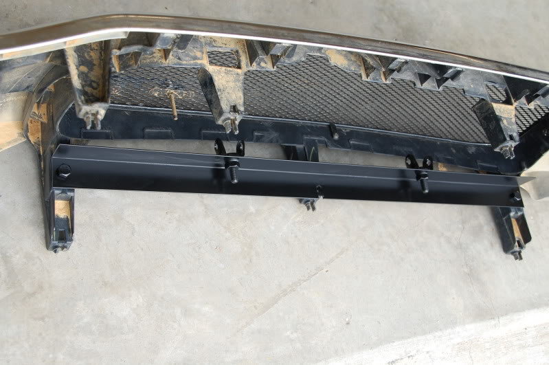

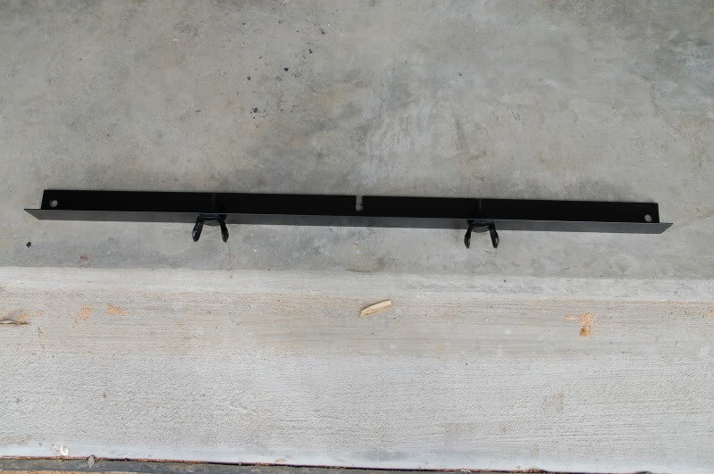

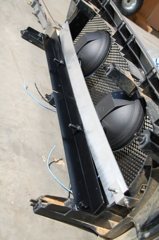

    here are the picks of mine on the first gen.
    a few of the bracket:
    heres how the bracket mounts to the grill:
    and the lights mounted to the bracket:
    heres mounted to the grill with a little extra support so they dont vibrate:
    finished product:
    all in all pretty easy. had to do a little minor trimming on the bracket to clear the AC lines and then it went right on. i put some male/female connectors on the leads from the lights so that the grill can be removed as an assembly as well

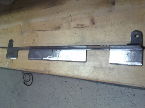

    Well I was working on the bracket Sunday and made some good progress but I think I might have to scrap it and start over if I can't figure out a way to make it work.
    I notched the angle iron so my lights could tuck back since they are so deep and that all worked perfectly.
    Now the only issue is the height. If I use the current setup they will hang too low. However to get to the height I need the light mounting hardware needs to be above the horizontal bar. That would create a problem because it would then be hitting the grille brackets that attach to the truck.
    Hmm back to the drawing board to make this work somehow :cool:
