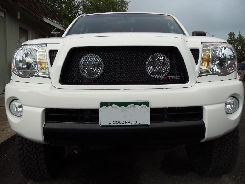

    My light bar is essentially the same as Klipps, except mine is more of a hack job since I didn't have much for tools on hand. Once it's painted black, it seriously disappears. Here's some pictures... hopefully they are close enough!

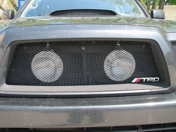

    so i measured today, and there should be no problem putting a third hella 500 in the centre if you wanted. they're just over 6" wide, and i've got about 8" between the two lights.

    OME 885 coils, Bilstein 5100 shocks, 1.5" AAL, TC uca's, cab mount chop, 5000k HID heads and fogs, LED tails, satoshi GC w/ Hella 500's mounted behind it with 5000k HID upgrade, Extang solid tri-fold tonneau cover, Yakima roof rack, fog light anytime mod, disable a/c defrost mod
    the power and ground wires from the hella would come close to that metal support coming down over the centre of the rad, but it would clear.

    '06 DC 4x4 LB
    here's a shot i took today in the sunlight. you can make out the chrome bolt heads, i still have to take a black sharpie marker to them... :cool:

    '07 4x4 DC Offroad
    Hey Klipp,
    I was able to go a bit wider with the IPFs without having issues contacting the tranny cooler. However, I think these are a bit further forward than your Hella 500s. The top of my glass lens contacts the grillecraft, just barely. Not sure yet if it will be a problem, but I can't move them back any further, either, as the center support gets in the way.
