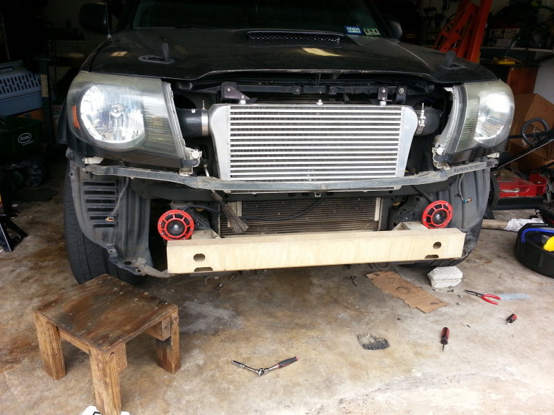

    Torspd Custom Turbo kit [] Borg Warner 9180EFR Turbo [] Haltech Elite 2500 [] TiAL Q BOV [] TiAL V44 Wastegate @ 15psi [] CP Pistons [] CP Carrillo Rods [] ARP Head studs [] ARP Main Studs [] ARP Header - Head Studs [] Ported Heads w/ 1mm oversized valves intake/exhaust [] Brian Crower Forged Stroker Crank [] Darton M.I.D. Sleeved Block [] Kelford Camshafts [] Torspd 160* T-stat mod [] APR Large Fuel Rail [] Walbro 460 LPH E85 Fuel Pump [] FueLab FPR [] APR T56 Conversion Kit [] KP RACING Built T56 [] McLeod Racing Custom Twin Disk Clutch [] One Piece Aluminum Driveshaft [] MGW Shifter [] Custom lowering kit [] Ohlins Front Coilovers [] QA1rear shocks [] Custom Ron Davis Radiator [] Dual SPAL Electric Fans []
    I'll contribute.
    No relay necessary.
    Drilled holes to fit studs for aluminum crash bar. Extended postive oem wires. Grounded other terminal to other crash support stud.
    Biscuits, K Williams and privatejoker like this.

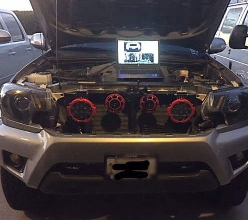

    Thanks for the write-up OP!!! Followed all the directions exact for a quick Friday night project. These horns spew the brown note I am pretty sure... Definitely loud in person especially if you are right in front of them! They will destroy your ears in a garage... Very happy with them!!

    Awesome! Had 4 on my WRX and thankfully remembered to transfer them
    Johnny DemonT[QUOTED] likes this.

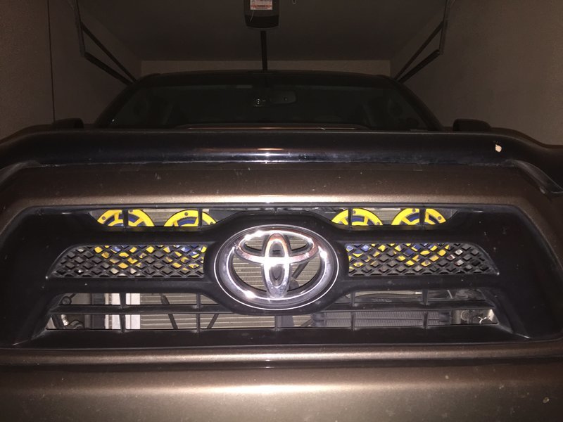

    Westin step bars
    Sweeet! did the same to mine but used heat shrink for the bare connectors. I had mine sitting the same as yours but they sounded even louder beside each other. Just used the second bolt from factory bracket and the 3 thin supports that came on the back of the horn. Found mine on Amazon for about 48bucks though. I think that included shipping. A lot of times I have checked amazon and they are cheaper than the automotive sites depending on product. My wife thinks they sound wimpy, "they just don't sound like a truck". They will get the attention of idiots though.
    Tectonic likes this.

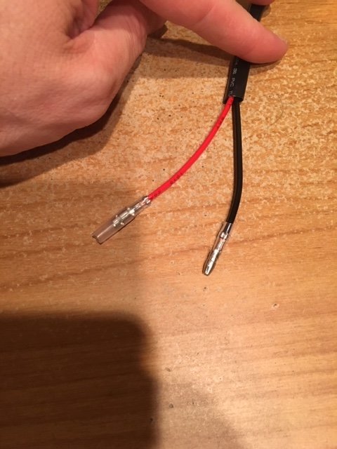

    Hey Guys, kinda new to the forums here, but not a stranger to vehicle hobbies. I have an issue tho, I just purchased the hella tones a perrin brace and a harness for installing and I have a wiring question. I have two stock horns and im not sure which wires on the stock harness are the positives to connect. The harness kit I purchased has a built in relay and has a red and black pin like connector not a spade connector, other than that I can install the rest just fine, for now I mounted the horns just havn't got the electrical hooked up. attached is a couple pics and the ends of the wires im supposed to connect to stock wiring, just not sure how. any idea?
