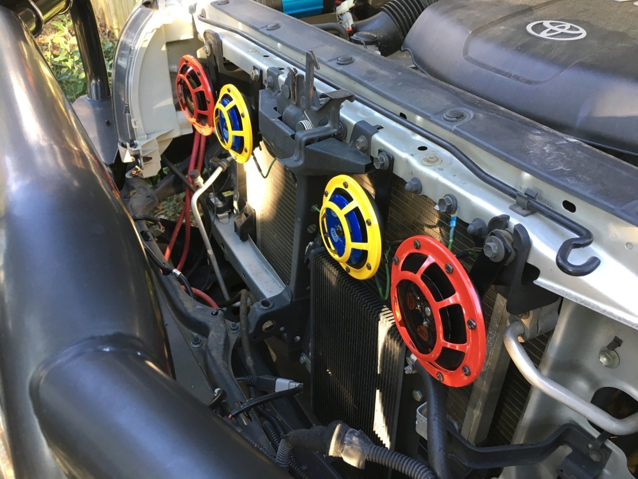

    Kinda funny the OP paid 70 bucks for two. I paid 65 bucks for 4 of them..... no clue how I wired them. I did it too long ago. But its loud AF
