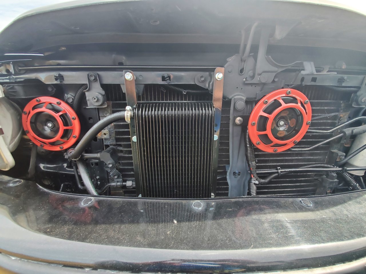

    I don’t know if anyone still watches this thread but I don’t know how to connect the relay to the stock horn wire. I have the power connection for the battery, the individual horns, but I don’t know how to connect the final part. Can anyone help?
  5. Jan 17, 2020 at 2:51 PM
    #105
    Muddinfun
    Muddinfun Well-Known Member
    Apr 17, 2017
    #216500
    7,489
    Terminals 85 and 86 on the relay are the relay coil terminals. Connect terminal 86 to the factory horn wire that previously went to the horns. Connect terminal 85 to the body.

    This was what I was talking about, thanks @Muddinfun, I just hadn't read that far yet. I'm still very new to electronic components so I'd be horrified if I messed everything up.

    I used the factory wire, then grounded the other wire to the chassis. No relays. Simple.

    I did the 4 note Cadillac horn mod a few years ago and did the same thing. Easy peezee.

    where did you connect it to the original wiring? im having the same problem and i want to avoid splicing if i can.

    I would imagine where the ends of the plugs go to the horns. I did this mod awhile ago in conjunction with Hella's air horns.

    They aren't spade connectors though it is thinner skinny ones not sure the name. Has male and female coectors

    You can always trim some spades to get them to fit the existing connector.

    How did you wire it? I can’t find out how to it’s killing me! I have the quads also and have the 4 pin relay from hella horns but this whole wiring is confusing

    don't use the relays, not needed. just use your stock wiring.

    I have a 2015 Tacoma 4x4 Sport Double Cab SB and want to install SuperTones...but my truck has two stock horns. I have done some Googling and haven't come across an install...any ideas regarding wiring?

    Use stock wiring

    So, us the stock wiring coming into the stock horns for power, ground the SuperTones and I'm good? No need for the relay?
