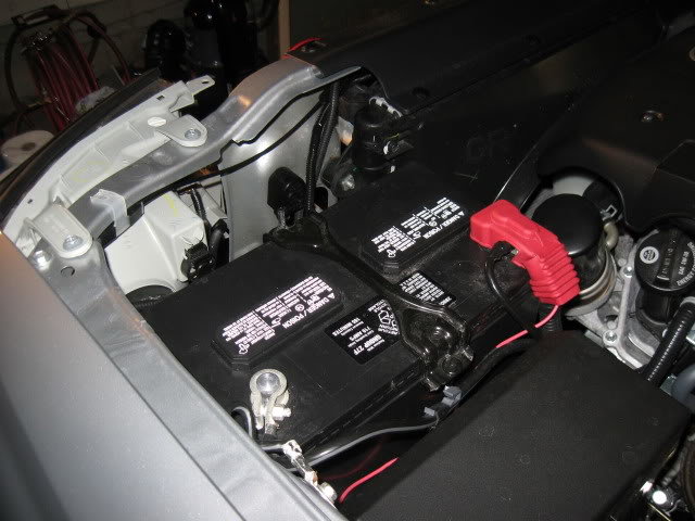

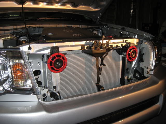

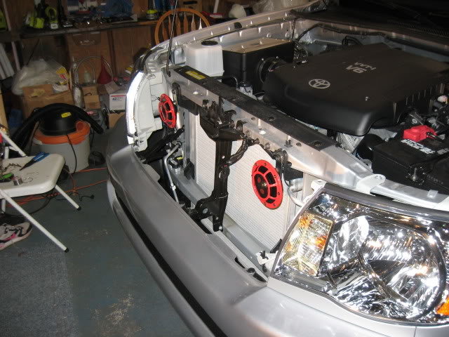

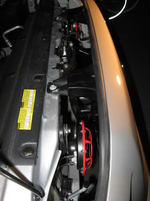

    i used the existing upper condenser bracket bolts to mount the horns. i wanted to do what KPT did with his installation but couldn't get corner brackets that would work with the holes he used. no matter because this worked out perfectly.
    this installation took me about 4X as long as it should have. i used a bunch of terminals that i harvested from a box of various harnesses i had in a box that i finally sorted a while back to make my wife happy. that meant that every connector involved a soldered and shrink splice, which took a while! every connection is soldered with shrink, plus tape and loom where applicable to make it appear factory. the spade connectors have shrink over them for protection and i also used dielectric grease on all terminals. i found two holes in the side of the engine bay that worked perfectly with two metric fine thread stainless bolts i had, so i mounted the relay and fuse holder there. great because i refused to drill for a horn installation. keep in mind the Supertone kit comes with the horns, a relay and instruction sheet. no wiring or anything else.
    the video doesn't pick up the bass of the low tone horn. trust me it's there. SO loud and obnoxious.

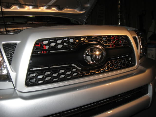

    Nice Work! I'm sure much louder in person...
    I say pop the horn grill's off and paint them black for more hidden look

    Nice I like how you did the install without using the brackets. Can we get a shot of straight on to see how well you can see them behind the grill and how far apart they are spaced?

    and they can be moved closer together if need be, or the other way too, since i have them hanging straight down.

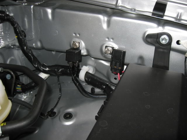

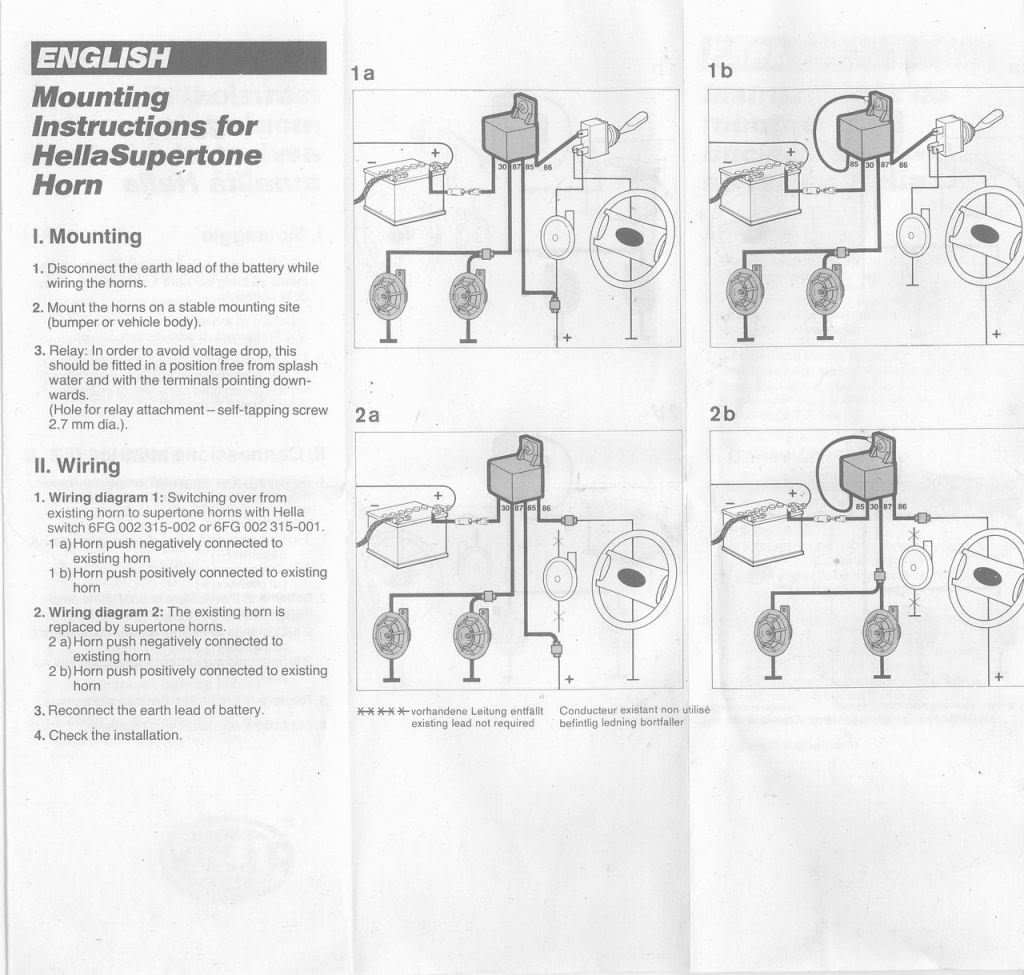

    But I don't know how to wire them.. OP, Do you have a drawing for the wiring ??
    Thanks

    i could scan or take a photo of the various wiring diagrams - it depends on how the OE horns are activated, but for the tacoma, it's simple:
    horn "positive" goes to the Hella relay, fused positive goes to the relay, ground goes to the relay, and then a wire comes from the relay to the horns - they both share it. Then you simply ground each horn.
    The positive signal from the OE horn wire clicks the relay, which sends the fused power wire power to the Supertones. Simple. I just went overboard and did it as the factory would do it, and also used recycled parts to do it, hence the long installation time.

    really? that is surprising. not to insult you, but if that was confusing, you might want to consider having someone install them for you.
    here is the instruction sheet i found via google images. you would be using "2b" for your wiring.
