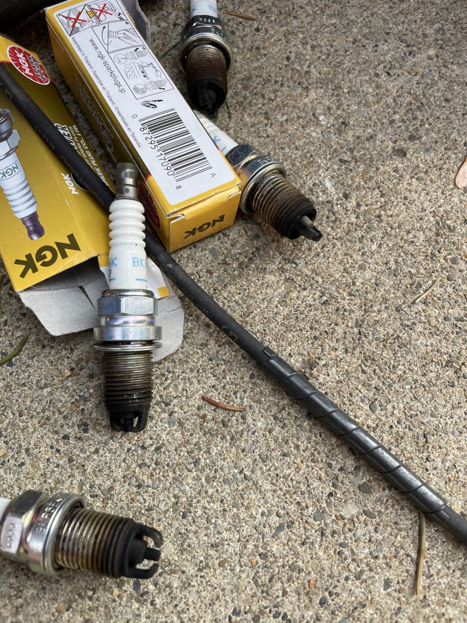

    Hello I just joined this forum because I feel like it must be a good one. I am having some trouble with my 2001 Toyota Tacoma. I just recently redid the valve, cover gaskets and manifold gaskets and when I put everything back together it was running too rich and won’t run the way it used to purr. So then to try to fix the problem I did a tuneup with new coils, new spark, plugs and wires and it’s still running way too rich and also running too much like shit to drive. I have a family mechanic that says he thinks changing the spark plugs will help and using fuel injector cleaner, but it Hass to be something a little bit more complicated than that. Any input is very much appreciated!!

    Replaced the valve, cover gaskets and the manifold gaskets. Upper and lower manifold gaskets. I know it’s running rich because of the spark plugs I replaced, and then double checked the new ones. It is throwing codes for misfires, which makes no sense since it was purring perfectly before I did all this. It was just leaking oil and I didn’t like it I did replace a cracked vacuum hose already that didn’t make a difference. I need to quadruple check all of them but I have been looking. Someone said they thought maybe I disturbed the fuel injection and that’s why it’s running rich and like shit but I’m not sure what to look for along those lines

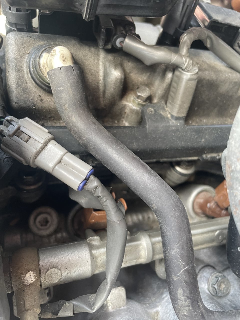

    Found it!!!

    It was this one !!

    PCV hose, that would definitely be a huge vacuum leak.
