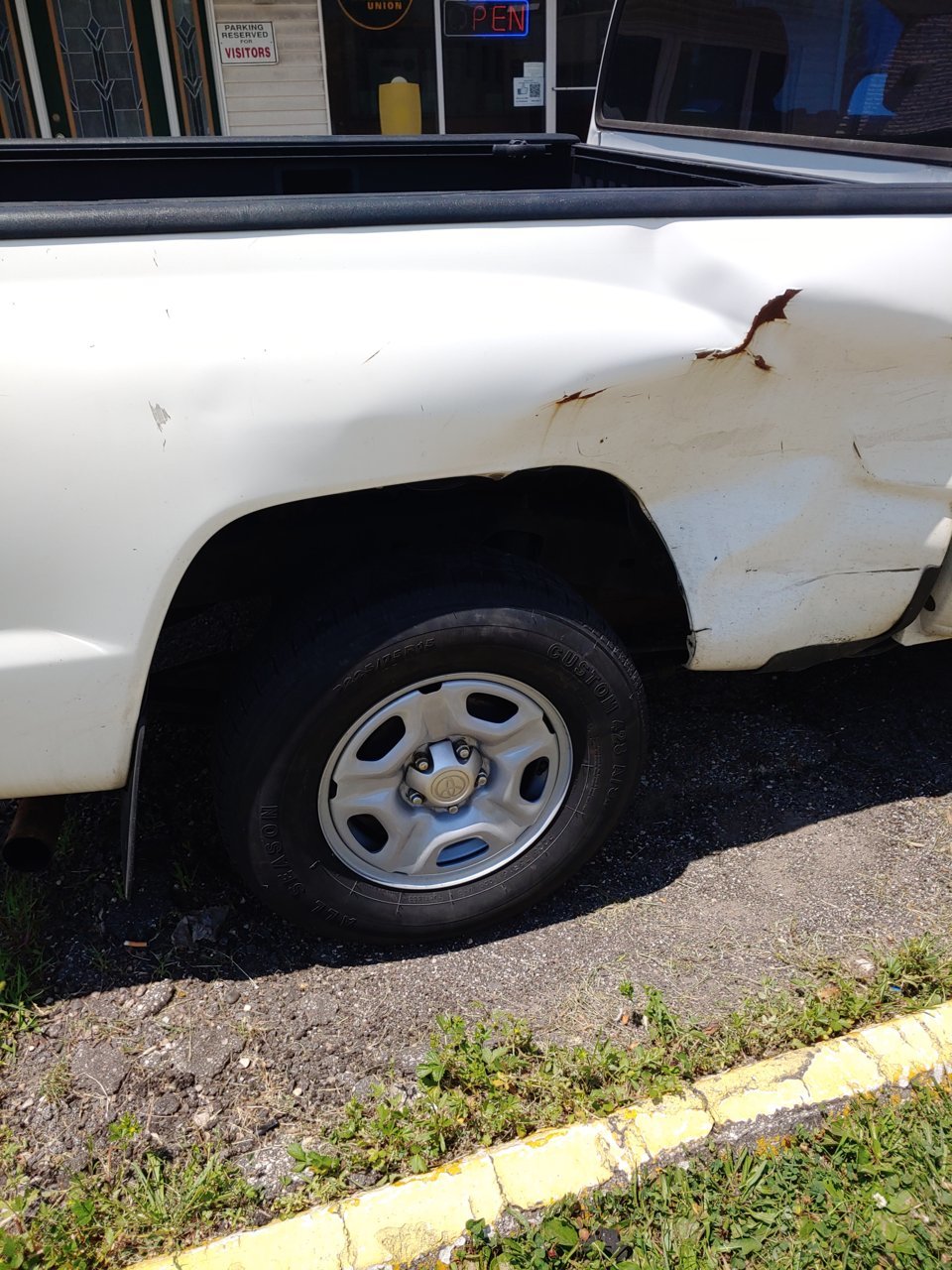

    2007 Tacoma been hit. Passenger rear tire was pointing outwards. I had the bent rim changed and balanced the tires. It still has vibration from 40 to 70 mph then goes away after 70. Thanks

    rear axle is probably goofed if the tire pointed "outward"

    If you pull the tire off and spin around the brake drum it might be pretty obvious.
    If it is wonky, your best/cheapest/fastest option will just be to buy a used axle and swap the whole thing.

    Could be axle is just off center, pinion seal, drive shaft, carrier bearing, hub or axle completely toast or just ubolts are loose.

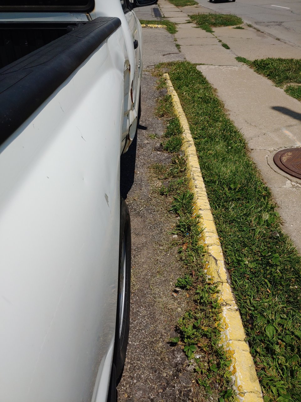

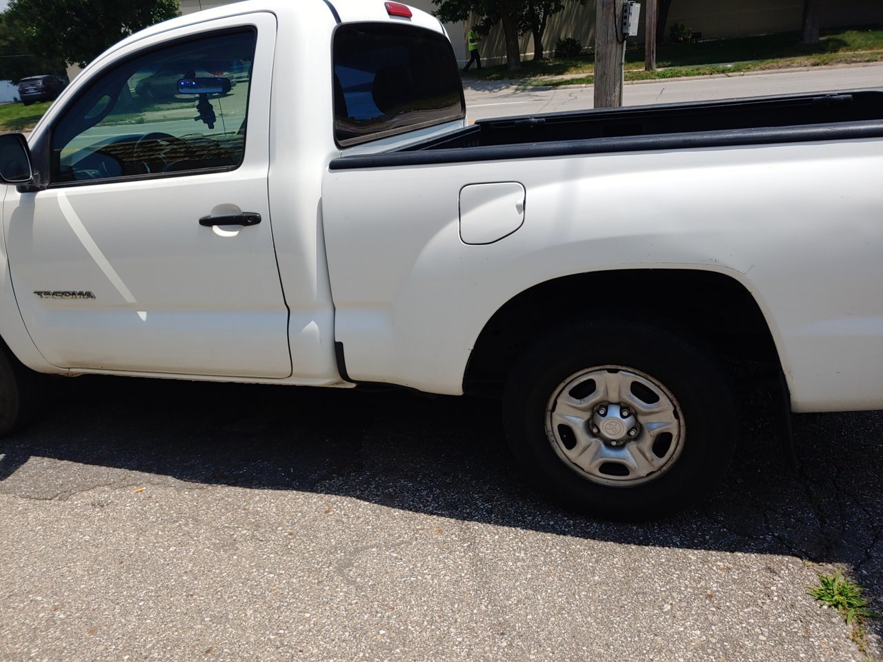

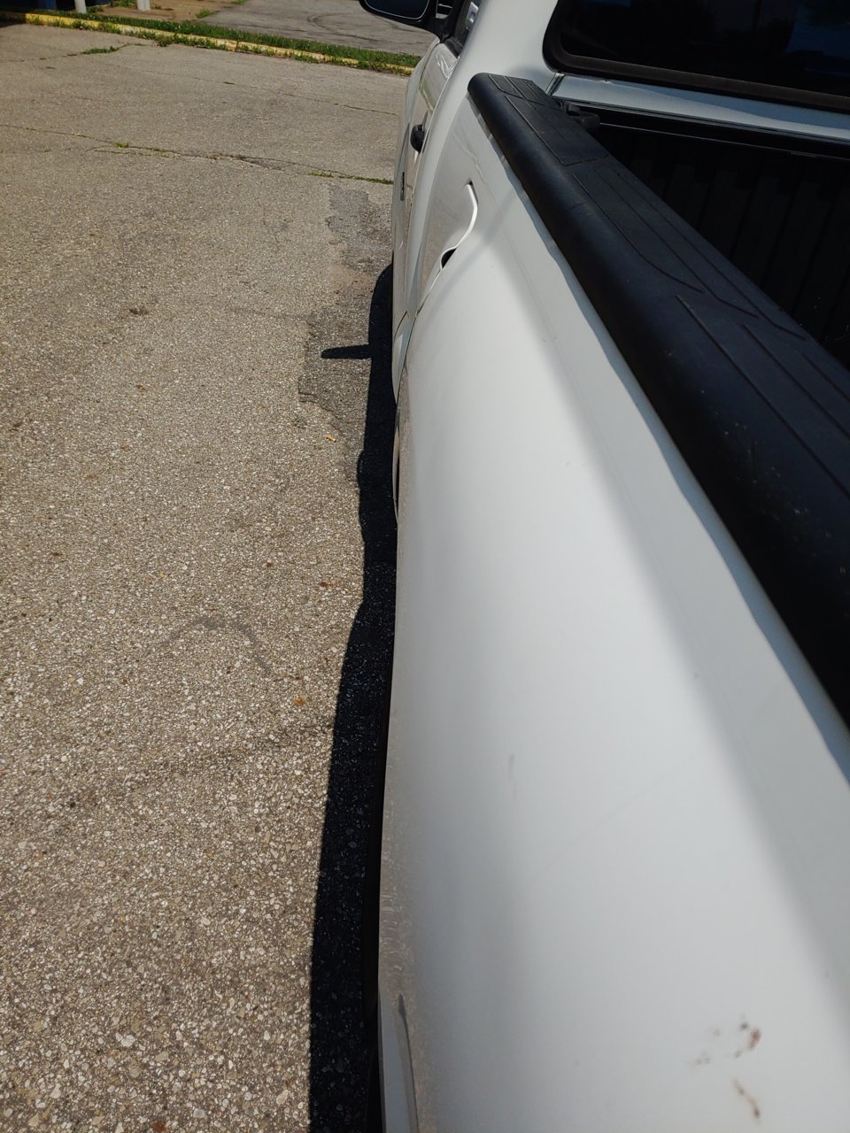

    What does the other side look like. Is the angle matched?
