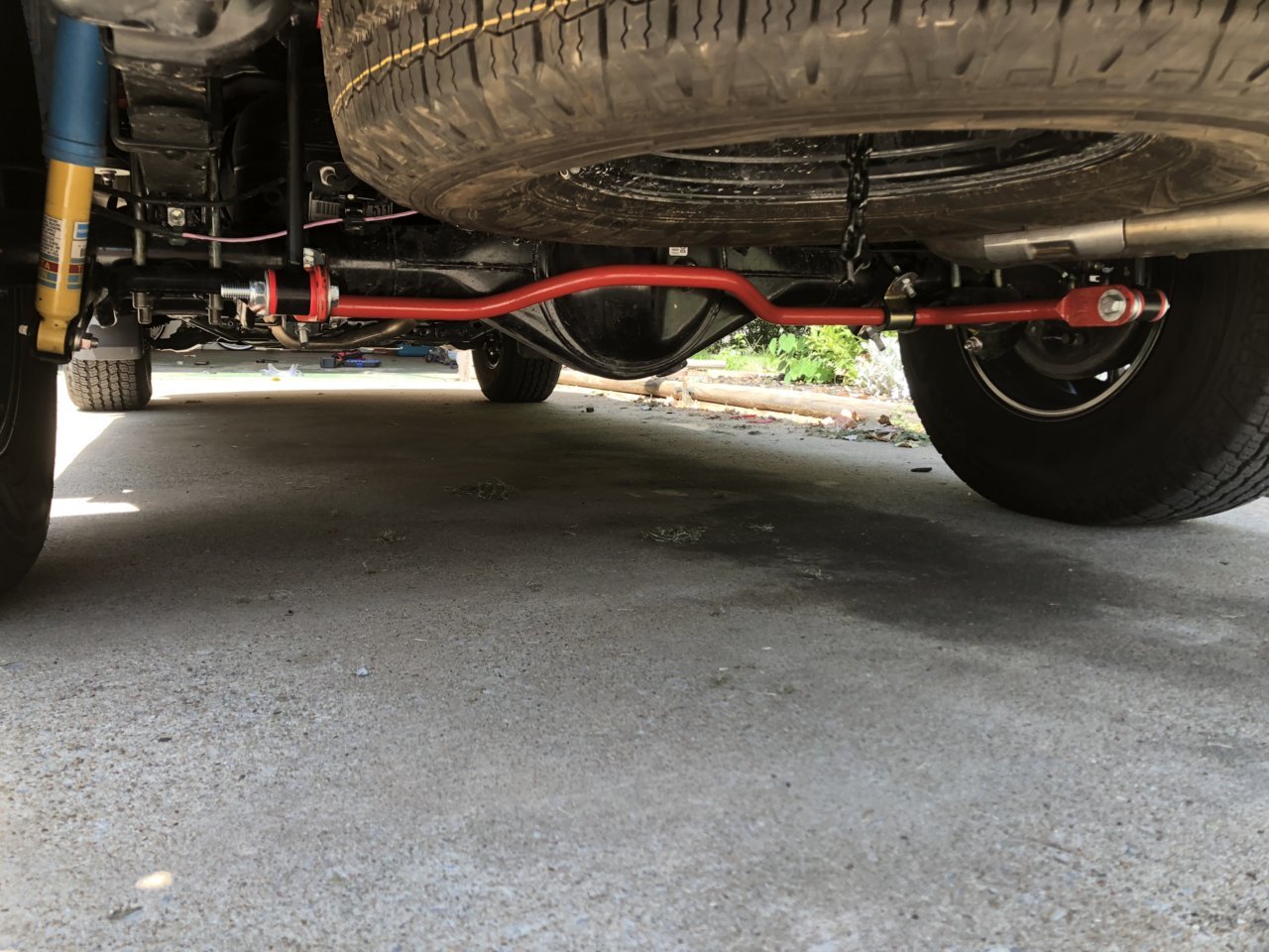

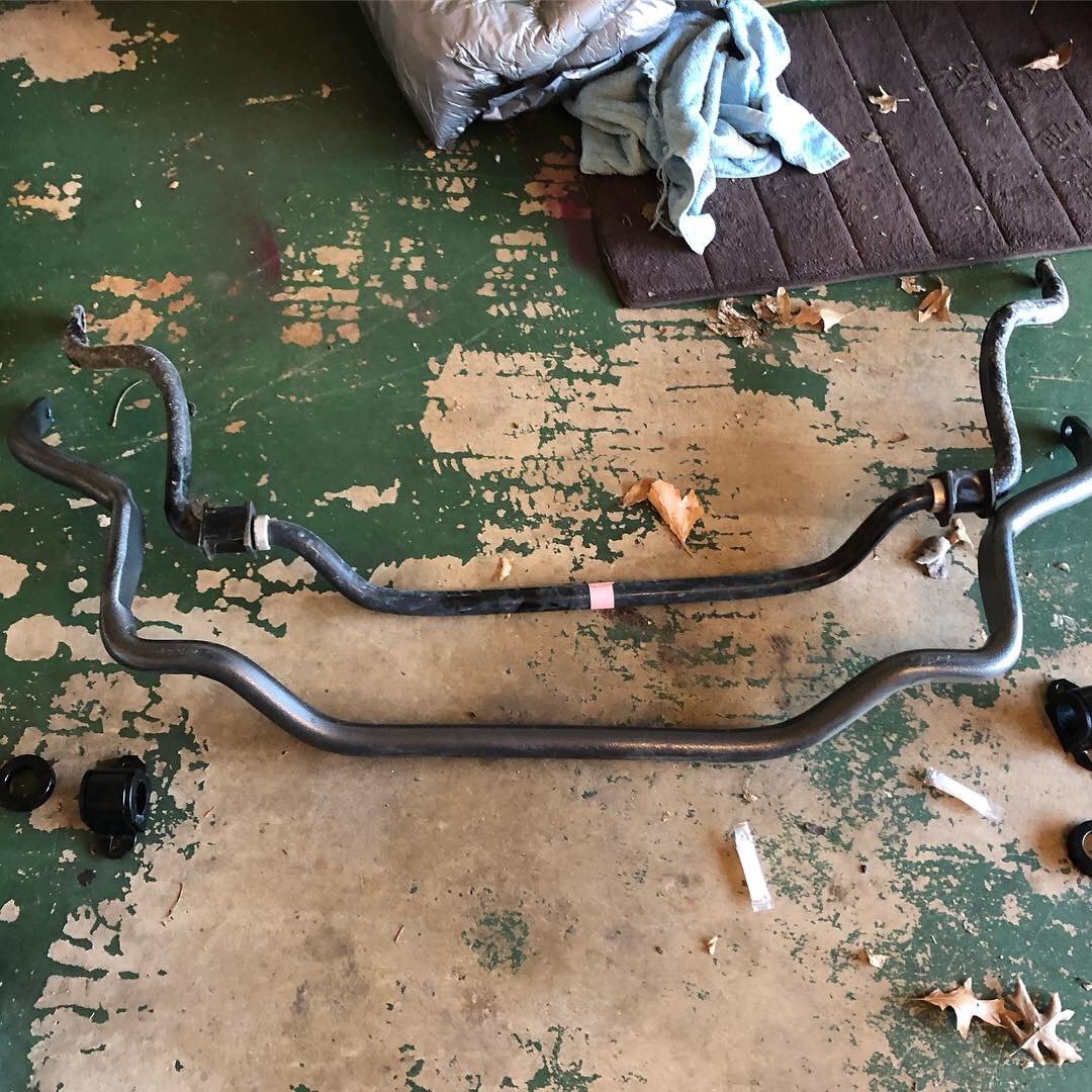

    Thought I’d add a little bit to this thread.
    I just installed the hellwig front bar today. Took about 45min. It’s a good 1/2 thicker than the stock bar and very easy install and really reduced body roll.
    Remove skid plate->remove front frame supports->unbolt sway bar body brackets->unbolt end links->reverse for install.
    Handling is greatly improved. There’s still enough body roll to be comfy, but it stops abruptly and goes into corners with much more control, traction, and confidence.
    My rear bar is a modified Toyota X-runner bar. Hellwig 7744 is a bolt on kit for the rear I would reccomend instead.
    The rear bar makes a massive difference for spirited driving and towing. These trucks are designed to understeer from the factory for comfort, the rear bar makes it more neutral. I highly reccomend installing a rear bar. It is the single most rewarding mod I’ve made on a daily driver.
    A lot of you are worried about loss of off-roading ability. If you are a rock crawler this is not for you. You need all the articulation you can get. If you are the type of guy that drives across your field, crosses a small stream, etc, to go fill up your deer blind or get to your favorite shade tree, you won’t notice any loss of off-roading ability. You simply don’t need that much suspension articulation for every day off-roading.
    If you do find yourself needing to climb a rocky steep trail, you can also quickly unbolt your end links and hang the sway bars out of the way with zip ties to regain full suspension travel.
    Front and rear sway bars were worth every penny to me. It’s almost like driving a sports car... er sports truck on the road. Snappy handling, and great control for a truck.
    Hellwig 7719 bar bottom, vs stock bar (top)

    My Xrunner rear bar. You should buy a hellwig 7744 bar though.

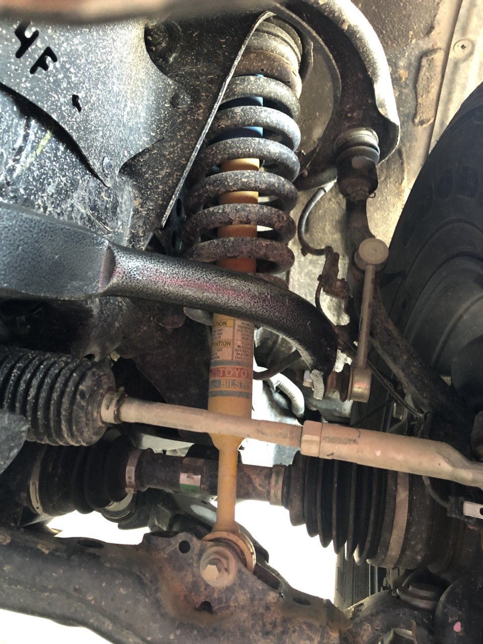

    I just installed my Hellwig 7744 rears on stock height Bilstein 6112/5160 and what a massive difference it made! My truck is mostly used for very windy/twisty highway and for the first time it was a pleasure to drive on tight corners going high way speeds even with a loaded bed!
    I bought the 7719 fronts as well but I am having trouble with the install. After bolting the sway bar to the end links on step #5 of the instruction manual, step #6 is to simply flip the way bar up to contact the frame and line up the U-bracket holes. For some reason mine do not line up... either they sent me the wrong one or am I missing something here? The Hellwig sway bar I got the D-bushing sits angled vs the factory one which is perpendicular with the frame. In the picture below, the red lines are where the frame holes would be. There is no play in the bracket for it to rotate to line up with the frame holes and if I push it too far the D-busing starts to come off the sway bar.
    EDIT: Turns out they sent me a defective bar after reaching out to Maria at Hellwig. She said the tolerance is off on the sway bar I got as well as the ones currently at their warehouse. They are going to make a new batch and send me a replacement. Guess whoever was working that day must have been sleeping on the job, so much for that made in USA quality! :rofl:
