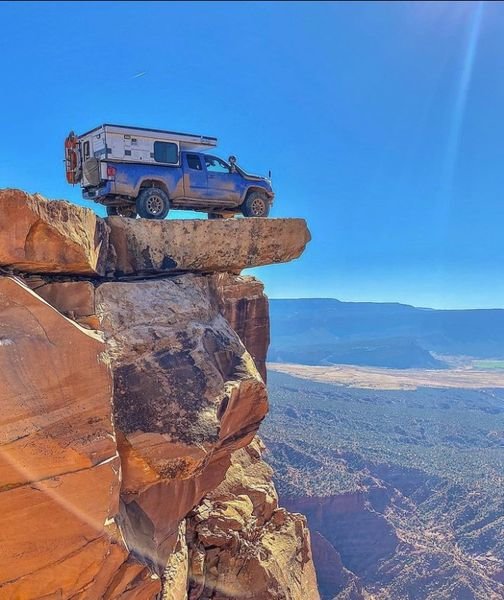

    Long travel house on 35s with a custom aluminum utility bed and FWC
    some welding required
    Realistically the weight of a pop top slide in is pretty low. yes it raises CG compared to an empty bed but my water tanks and batteries are at the bed floor height.
    I've run the camper more off camber than I'm particularly comfortable with several times, but this is on fairly technical trails that people with built up wranglers claim they pucker on the off cambers.
    That said, think about what you're doing with loads that push you to or past GVWR. So far i haven't had any issues but I may be on the "have put a lot of time and effort into it" spectrum for rear suspension as far as camper carrying tacomas go.
