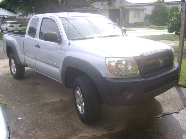

    this when i first got it had orginal tires on it...lol [​IMG]
