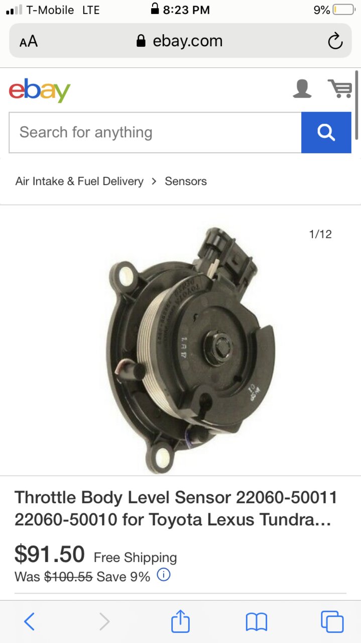

    I attached an image.
    So, I took this apart to investigate some more. It’s attached to the throttle body where the throttle body cable attached to.
    When I disassembled it, I turned the notch that opens and close the throttle body and it has about a useless 30 degrees rotation where it doesn’t close or open the throttle body. Could this be my culprit? Or is the ECM, APPS, and TPS supposed to all communicate to know that I’m pushing the pedal down?
    Just ordered a 4 prong TPS for my Throttle body. I guess I’ll see if that’s the culprit even though I don’t have any of the symptoms. It seems as if a lot of people have problems with them so it doesn’t hurt to try I guess?

    that's the way it's supposed to work. once you press the pedal the APPS reads how much, then tells the ECM to turn the TB motor, which the TPS reports back that is has moved.
    the delay in movement is "limp mode" if the ecm can't communicate with the APPS, TPS, or TB so you can slowly creep down the road if needed with about half throttle.
    this is one of Toyota's first drive-by-wire systems
