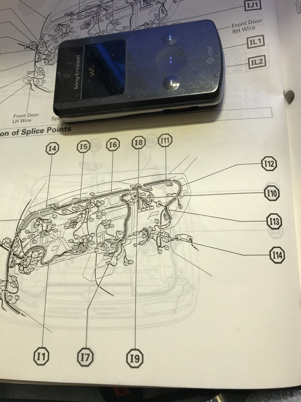

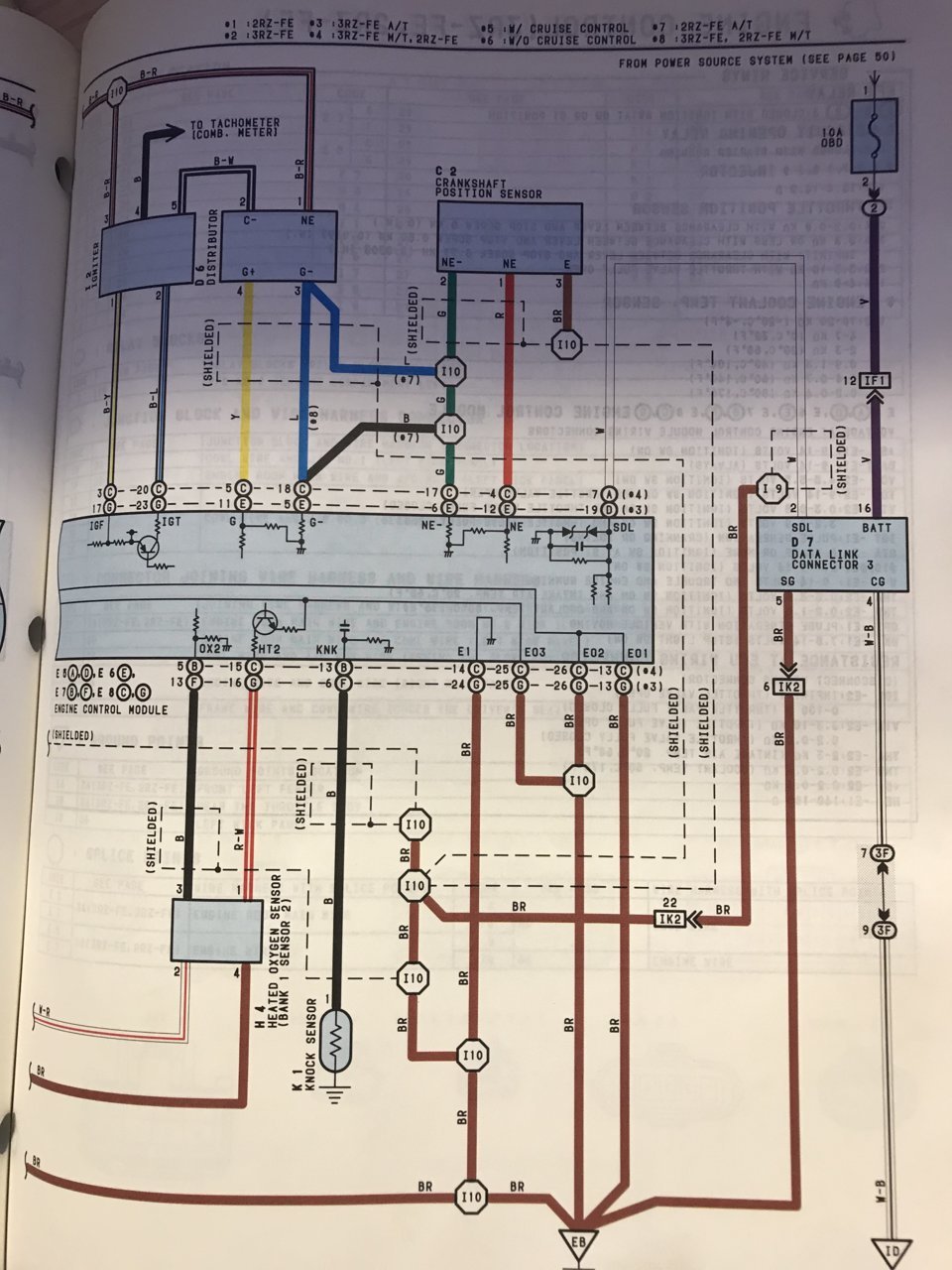

    Hey there people! I have no power to my crankshaft sensor. I have ground, I've changed the sensor. I have an aftermarket sensor and two original sensors. All my relays ar working. I've changed the computer. Only option I have left is my harness my have a pinch or a short circuit. Or I dont know if my distributor my be giving the correct voltage. How can I fix this?

    I hope this helps.
    I would check on either side of the splice for continuity.
    cruiserguy likes this.

    This started with A PO335?
    When the ECM does not see the crank Signal it shuts off the fuel.
    You have changed so much rather then trouble shoot the real problem.
    Have any new codes tripped since the adventure started ?
    So easy with all this unplugging and plugging to bend a pin causing a open circuit .
    A short circuit leads to open Circuit protection or at worst a Visit from the Fire Company.
