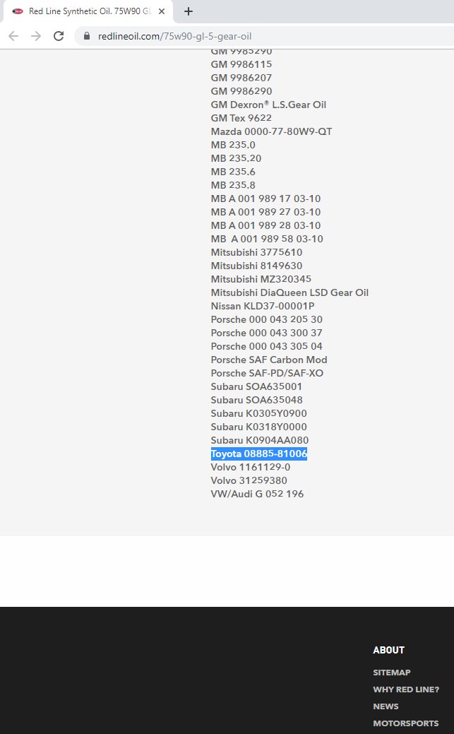

    Redline's product page (screenshot below) lists the Toyota 08885-81006 oil (Toyota's 75w-85 GL-5 differential gear oil) under the OEM compatibility tab. I just changed the oil in my 2018 OR MT's front and rear diffs with this exact oil.
    OP, one other quick note - if you're looking to change the transfer case oil, I'd recommend the Ravenol J1C1003 SAE 75W MTF-3 fluid, which can be had over at Amazon for ~$20/liter.
