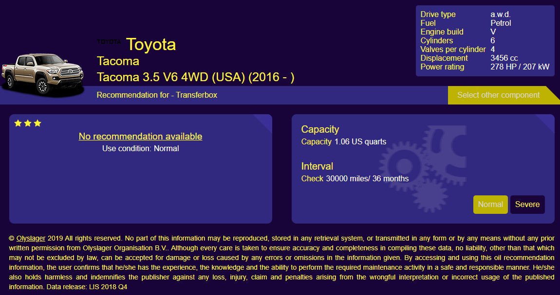

    That is a good question. On their website for the T case, this is what comes up:
    But, attached is a cross ref chart. The last item on the last page references Toyota LF. This chart is dated 2014 though?
    For the Ravenol, we are all going off of the Toyota 08885-81081 cross ref on the bottle and the straight 75w. This is from their website:

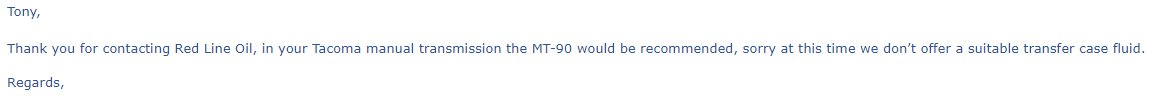

    And like I said above, I asked Redline about 3rd Gen MTs and T case:
    I figured that if I was bothering them about the T case, I'd ask for confirmation on the MT also.

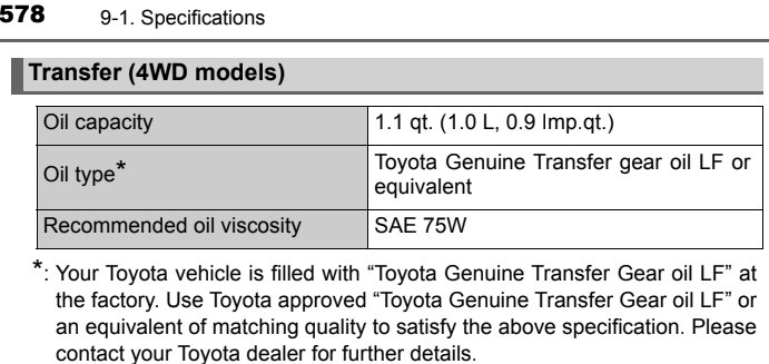

    Ravenol or the Toyota LF fluid:
    Ravenol is about 1/3 the cost, although there are VOAs that show the additive package is similar but a good bit less than the Toyota fluid.

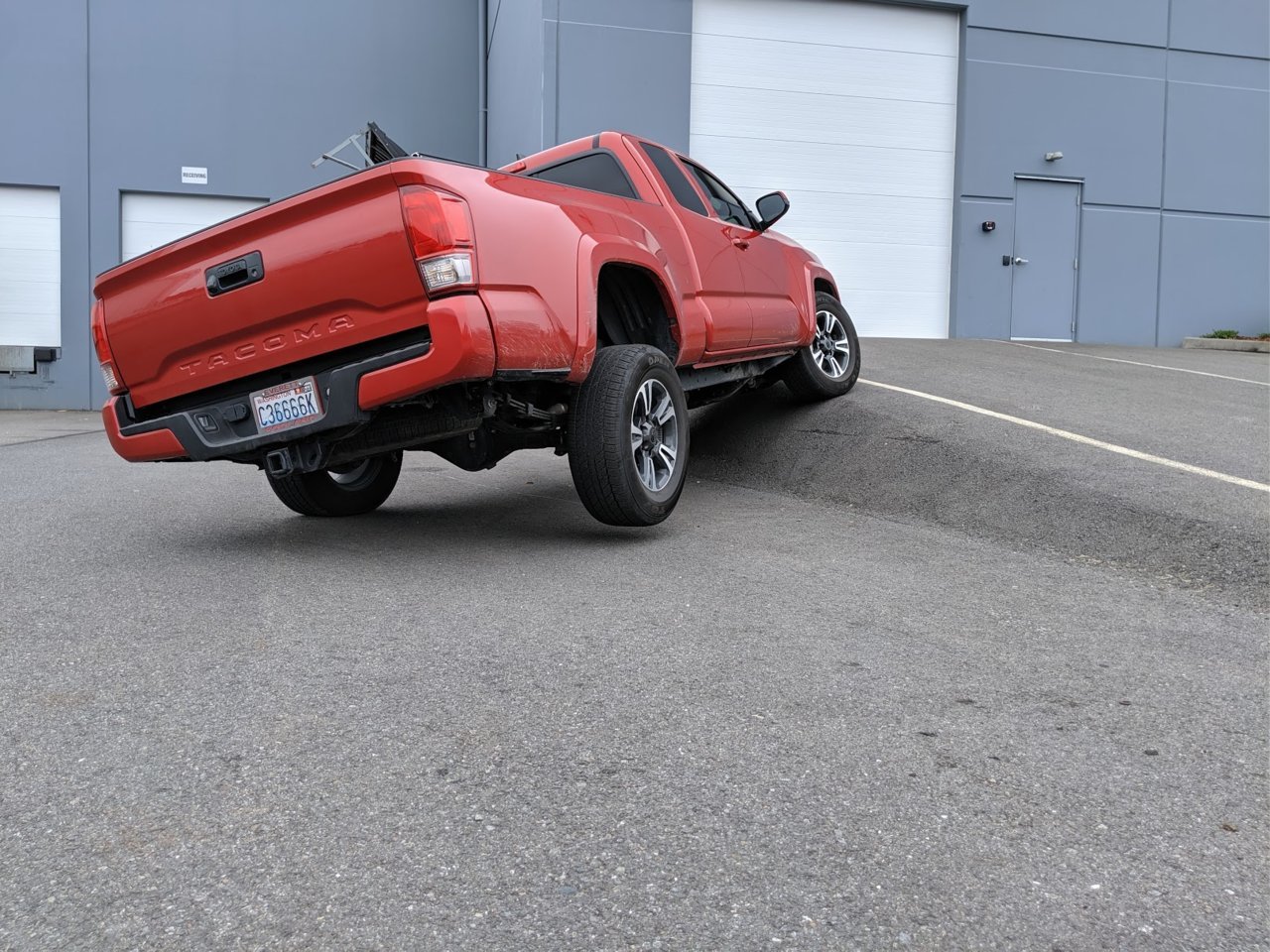

    The best thing that you can do is get out there and test:
    In the pic above both Auto LSD and 4Hi / 4Lo will creep me up and over the side of that ramp.

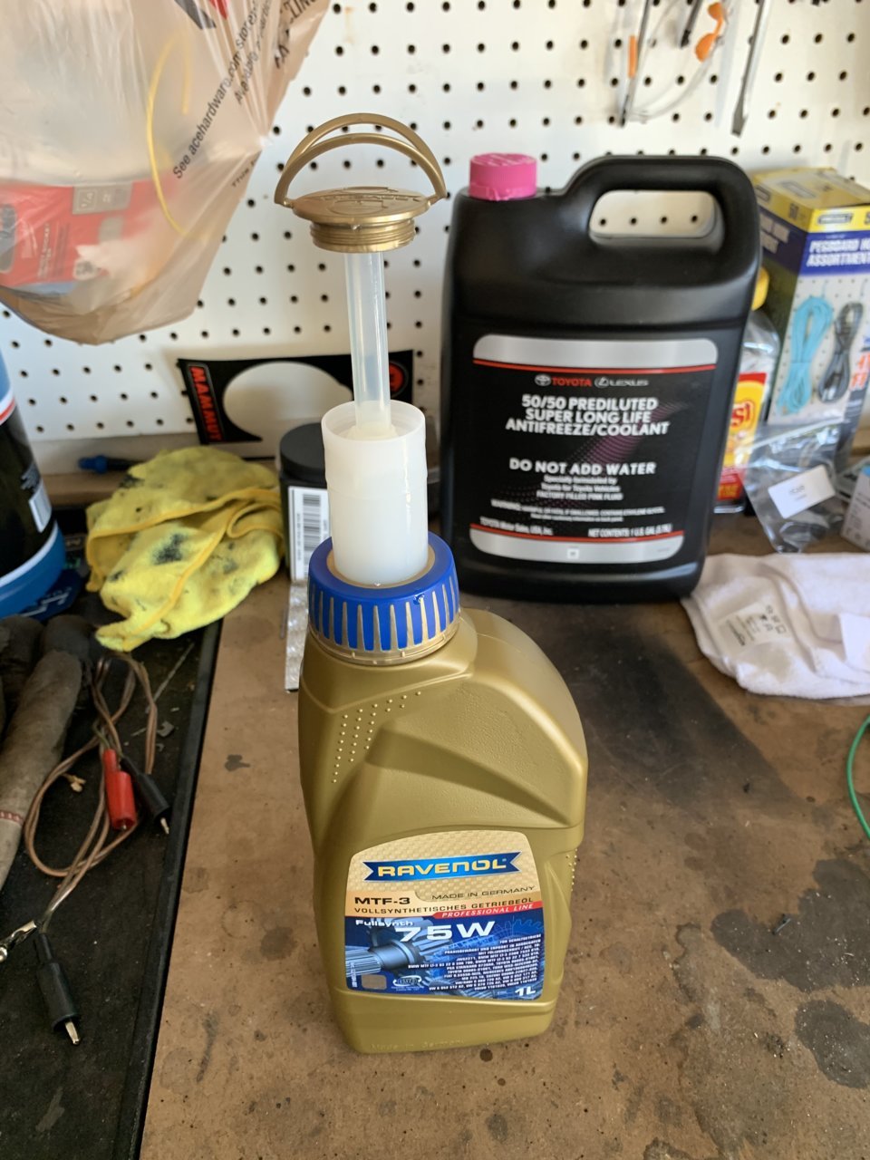

    Germans got shit sorted man. No pump / funnel needed.
