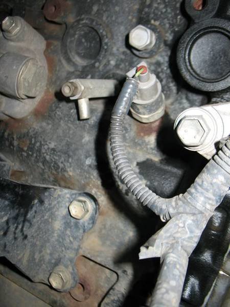

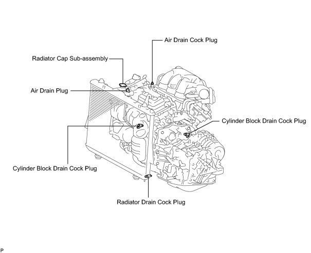

    I found this schematic online, its described at the 3.5 in the Rav 4 not sure if thats the same engine or not but may be a starttemp_zpscce70bf7.jpg~original.jpg

    Thanks i looked all over the right side of the motor and could not locate a drain cock like on previous years. There was one bolt that looked to be pipe thread but there was no drain cock. The schematic I found for the 2gr-fks online only showed one drain port on the block, not those additional but i will check to see if they are there.

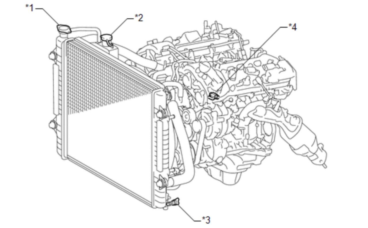

    Not sure if this helps you find the drain, but in some prior gens its not just a bolt in the block but more of a spout with a bolt on the end or on top of it.

    #4 on the image below is where the drain should be.

    yep that's the style i was looking for, couldn't locate it at all. The technical manual for the flush walkthrough only has a generic blueprint like what was posted above. If it's on there it must be buried. I even felt under the alternator and AC compressor and couldn't feel anything.

    IcyHott posted the schematic I was using, and I could not locate a drain port.

    I just went out and double checked again, there is nothing located in front or just below the oil filler neck like shown in that diagram.
