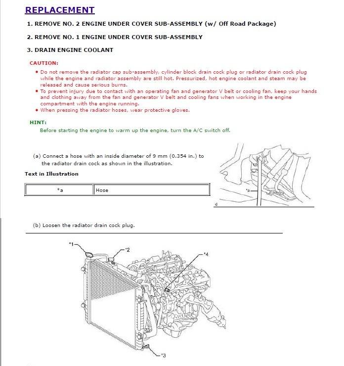

    Here's a tip for you folks.
    If you're having trouble loosening the drain-cock by hand....which sometimes happens...use a ratchet with a 22mm socket. Takes it right off. You'll just chew it up trying to squeeze pliers up in there, depending on exactly how it's oriented.
    Be mindful if you choose to tighten it that way. You can inadvertently apply a lot of torque. Tighten snuggly is all it needs. You can check for leaks once it's up to operating temp and tighten a bit more if needed.
    EDIT: This is assuming the drain-cocks are the same between the 2nd and 3rd gens. Willing to bet they are.

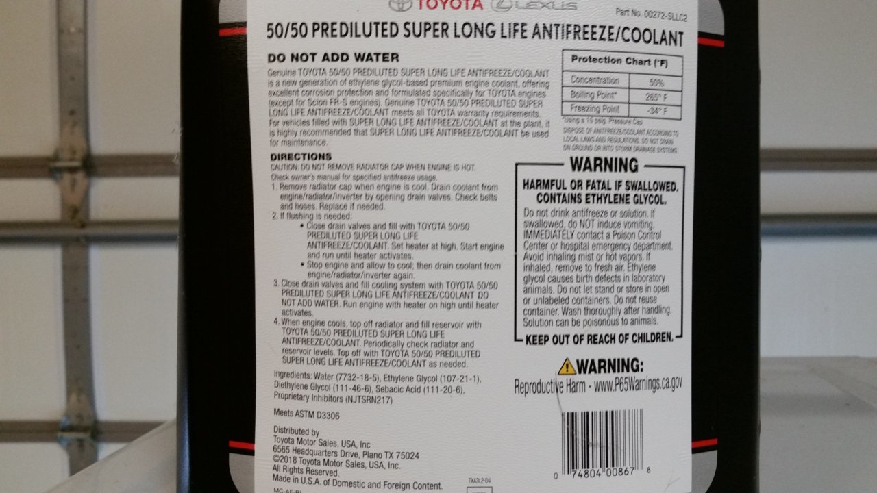

    google search "toyota llc vs. toyota sllc" seems to be plenty of chatter about it

    For reference...

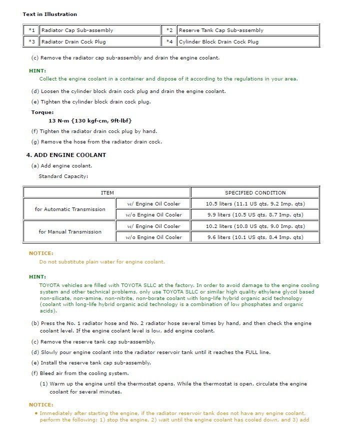

    Thanks, I don't think I'd bother changing the coolant 12+ times just to get 100% in there, I've seen similar models about transmission fluid, and on a more sensitive/critical component I'd say worth it. I don't believe the coolant system is nearly as sensitive as say a transmission. I think I may just try the flush technique but with SLLC, or try again to find the drain plug.
    @Plain Jane Taco the only thing I found so far that looks like a plug was definitely not a 22mm socket, I could have been looking at the wrong thing though. It did not have a spout either.
    @splitbolt were you able to locate it. I've looked at that diagram so many times and I can't find it on the block.
  18. Aug 13, 2019 at 8:42 PM
    #58
    fng13
    fng13 [OP] Active Member
    Aug 13, 2019
    #302057
    25
    UPDATE: I found the drain cock plug. It's on the complete opposite side (passenger side) and much lower than the toyota diagram above. It's on the passenger side, below the first outlet of the exhaust manifold from the front of the truck.
