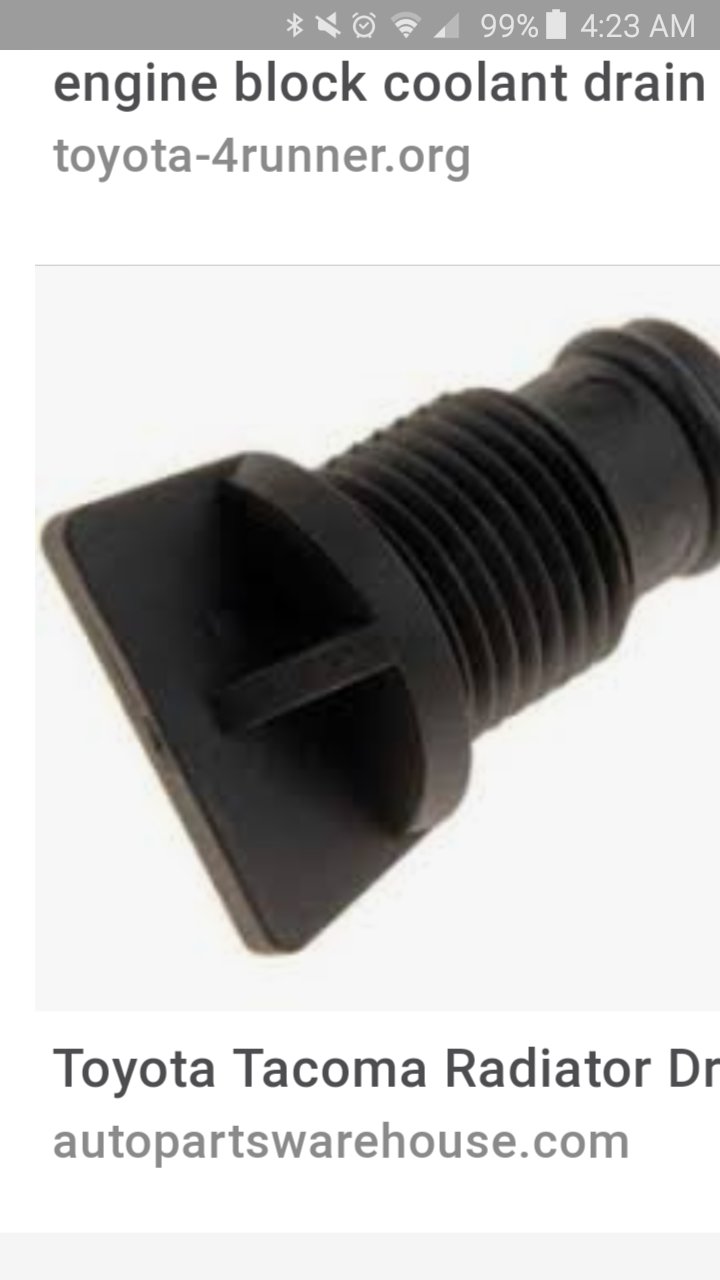

    Does it look like a wing nut? If so, a 22mm socket will fit over it....as weird as it may sound

    On the radiator yes, but the one on the block is a 10mm nut

    Yes... I was referring to the radiator plug
